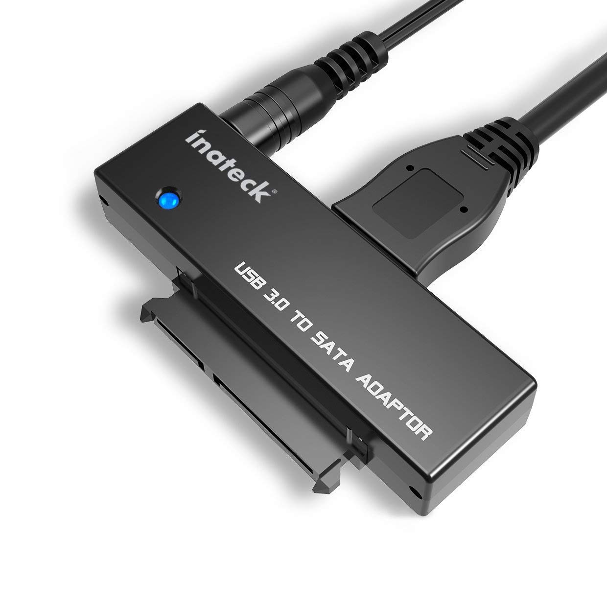

  • I already have in my saloon a BIG computer for Kodi only (windows version) and I want to make a small one with a Raspberry 4 and LibreElec
    Is it possible to plug 2 external 2.5 HDD on USB3 ports (1 per USB port) ?
    Will I need external alimentation for each HDD or a simple SATA to USB3.0 wire is enough ?
    Also can HDD be NTFS formated ? (especially for big movies with more than 4gb file)

  • Depending on the size of the HDD it should be possible. 2TB works fine but 4TB does not (Requires a powered USB HUB). Only real way is to try - Also make sure you have a GOOD power supply.
    For integrity of the HDD it is always better to have them powered by a USB HUB.
    They can be formatted as ext4 or NTFS it doesn't matter. LE can handle both.
