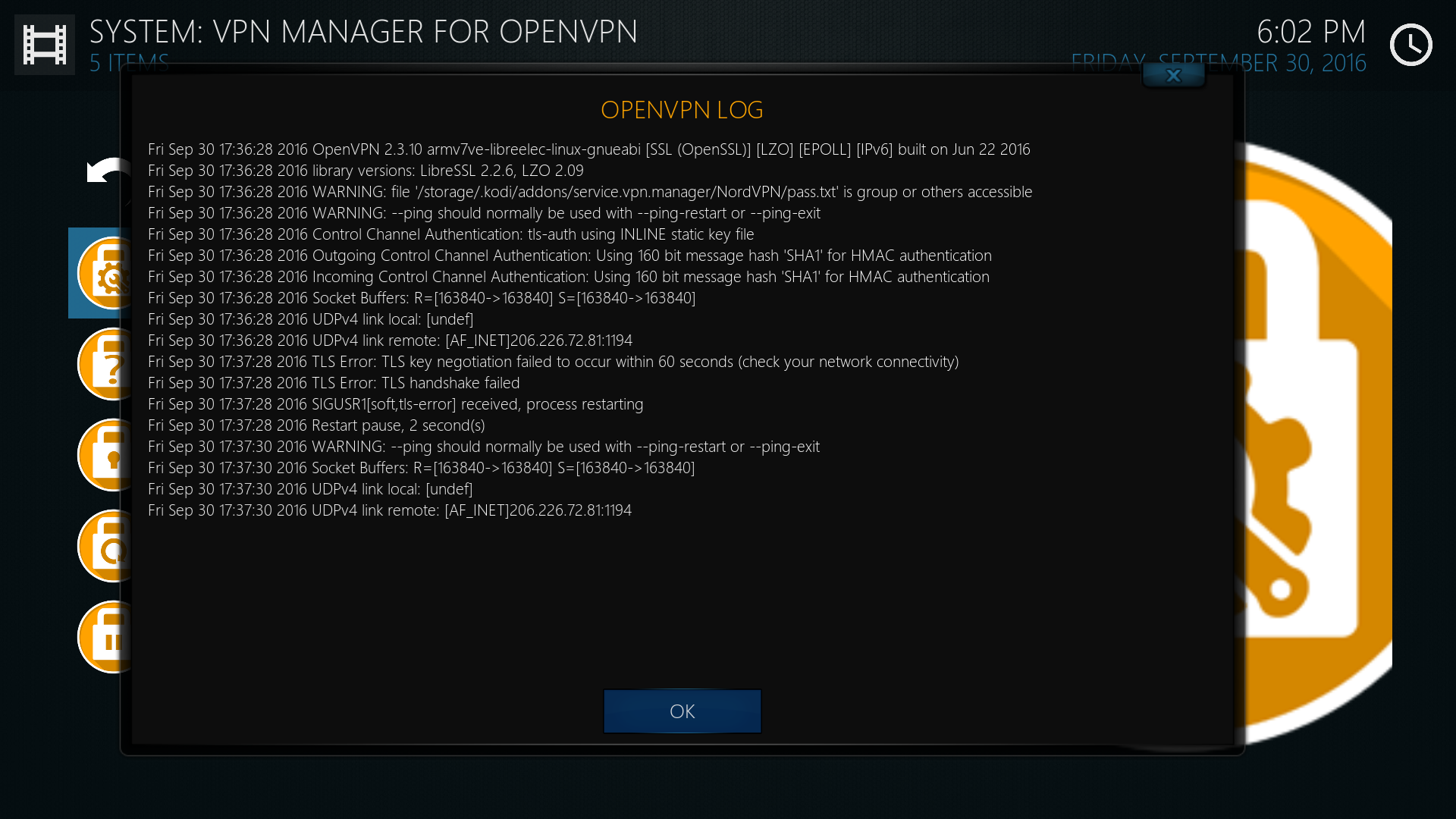

I cannot successfully connect to NordVPN using the VPN Manager addon with LibreELEC. I keep getting an error "Error connecting to first VPN, could not establish connection." I know my username and password is correct, and I have a stable internet connection. I don't really know what the problem is. I attached a screenshot of the log file.

It shows a TLS handshake time-out, so maybe NordVPN have a network issue or you're using a config that talks to incorrect servers - but ultimately that's a guess as I have no clue about that add-on. I suggest you contact the add-on creator for help; it's not one of ours.
Best to get support from the original the OE forums: OpenELEC Mediacenter - OpenELEC Forum - VPN Manager for OpenVPN (1/63)
Though first thing to try would be resetting the .ovpn files from the settings menu, that usually fixes any issues.

Have u installed OpenVPN as well? try installing this zip for openvpnErr.. you realise that OpenVPN is fully embedded in the OS don't you, so that's not required.
