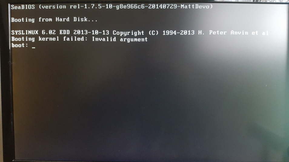

I did the same thing and now it wont boot.
I am at a black screen that says
Booting from Hard Drisk...
Syslinux 6.02 EDD 2013-10-13
Booting Kernel failed: Invalid Argument
Boot: _Any ideas?
[hr]Display MoreI did the same thing and now it wont boot.
Boot: _Any ideas?
after hours of reading I believe I used the wrong file. I used the file specified on the downloads – LibreELEC webpage for migration from openelec. It said nothing and listed no other files than the Raspi2. I was unaware of that at the time.
So now that I have the wrong file loaded... and cant boot, what do I do? I am totally lost. Any help you can offer is very much appreciated.

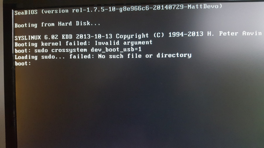

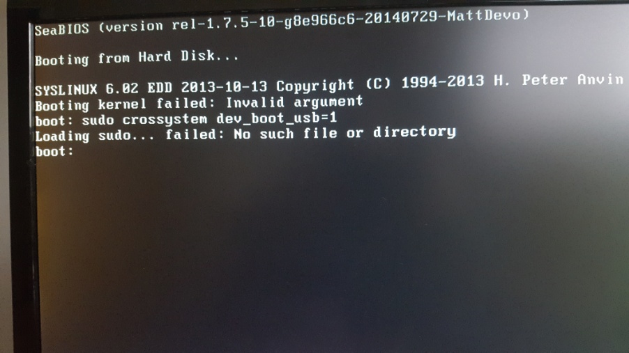

I will try my best to be as detailed here as possible as I sense your frustration and disbelief in the time I have spent attempting to research and solve this issue.
Up to this point I have been unsuccessful in accessing Dev Mode. I have tried all of the following with 2 different keyboards, and please keep in mind my box was not a dual boot box. I booted directly into Openelec.
With the box off , I have pressed a paperclip into the box, then powered on, and then released the paperclip. ... didnt work
Tried same as above but held the paperclip in the hole until I saw SeaBIOS at the top of the screen... didnt work
The methods listed below here have been attempted with and without the paperclip method listed above.
power on and hitting
ctrl+Alt+f2.... or
Ctrl+alt+f3.... or
Ctrl+Alt+T.... or
Ctrl+alt+D.....or
Escall gave me the same negative result . Here are pics of what I am seeing. I have also attempted to use the commands you suggest from this screen, and this was the result. I am trying everything I and find.
im ridiculously stuck.
