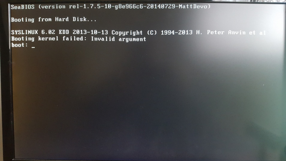

    I will try my best to be as detailed here as possible as I sense your frustration and disbelief in the time I have spent attempting to research and solve this issue.
    Up to this point I have been unsuccessful in accessing Dev Mode. I have tried all of the following with 2 different keyboards, and please keep in mind my box was not a dual boot box. I booted directly into Openelec.
    With the box off , I have pressed a paperclip into the box, then powered on, and then released the paperclip. ... didnt work
    Tried same as above but held the paperclip in the hole until I saw SeaBIOS at the top of the screen... didnt work
    The methods listed below here have been attempted with and without the paperclip method listed above.
    power on and hitting
    ctrl+Alt+f2.... or
    Ctrl+alt+f3.... or
    Ctrl+Alt+T.... or
    Ctrl+alt+D.....or
    Esc
    all gave me the same negative result . Here are pics of what I am seeing. I have also attempted to use the commands you suggest from this screen, and this was the result. I am trying everything I and find.
    im ridiculously stuck.

    How do I do I do that? I thought that hitting the cntl+alt+f3 would do that and I am not getting anywhere with that. I have tried hitting ESC several times on boot. That didnt work. I have tried 2 different keyboards with the same result. How do I access the bios on the chromebox? I know it may seem like I am a moron but pls trust me when I say I have read forums and searched google for hours and hours trying to resolve this issue. At this point I am completely lost and am truly at the mercy of the board. I cant not convey to you how grateful for your assistance .

    I did the same thing and now it wont boot.
    I am at a black screen that says
    Booting from Hard Drisk...
    Syslinux 6.02 EDD 2013-10-13
    Booting Kernel failed: Invalid Argument
    Boot: _
    Any ideas?
