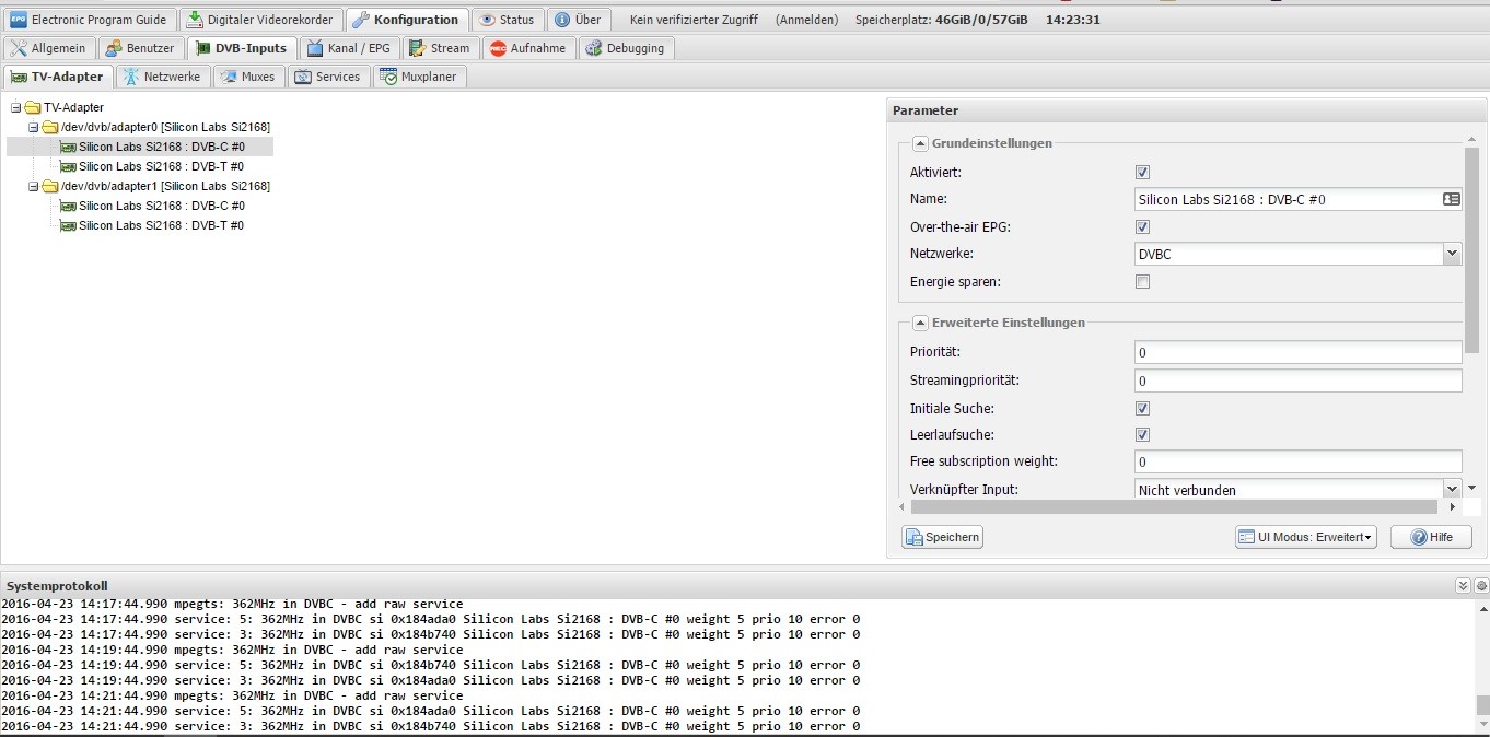

1 is VNC on the headless raspi, which won't work whatever i use (Open/librelec/Xbian) and the other isTVHeadend 4.2. Works flawlessly with 4.0, but i never got it scanning for Services, not the initial version in 6.95.x and not 4.1.1943.
I'm using a TT4200 (i think there are 2 Versions and i got the newer one) it is discovered without problems, but it won't scan anything, whatever i try.
