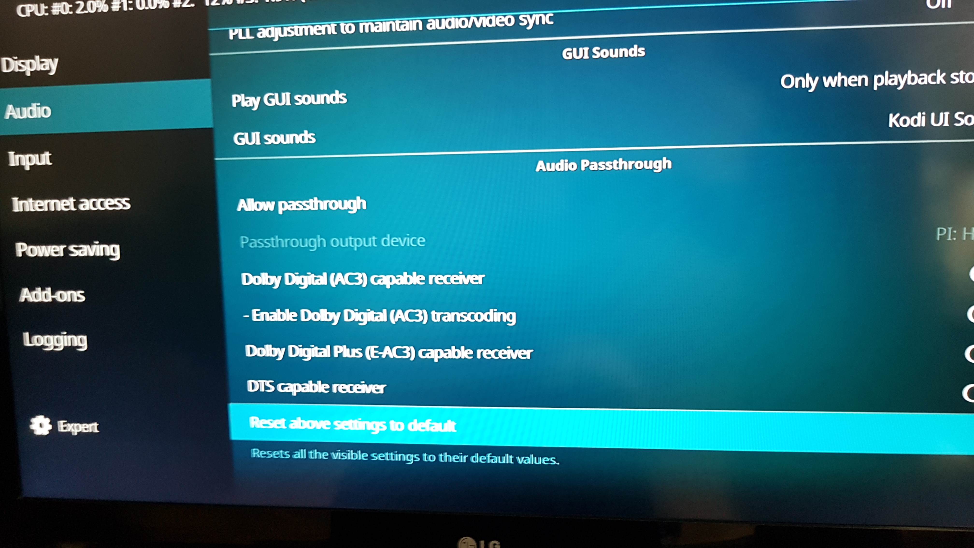

    I just installed LibreElec on a Raspberry Pi B+ and I'm trying to get it to stream bitstream TrueHD and Atmos to a capable receiver (Onkyo TX-NR777).
    In went to audio settings in expert mode, left all the settings to default and then I enabled "Allow Passthrough". Thing is that I don't see TrueHD or the DTS equivalent in the list. What am I doing wrong? I've been googling quite a bit and can't find a solution.
    In the logs I see "WARNING: Pulseaudio module module-allow-passthrough not loaded - opening PT devices might fail"
    system logs: http://ix.io/1g5v
    kodi.log: http://ix.io/1g5u
    (btw I think the dates in kodi.log are wrong, I deleted it and restarted the box just to be sure and the date are still like this)
    I've attached the screenshot of the audio settings.
    Thanks!
    Andre
  • Raspberry Pi 3B+ does not support TrueHD and Atmos and other HD formats. The HTPC hardware has to detect/handle the audio to "pass it through" to the AVR device so you'll get the DTS core sound not the full HD audio stream. If you want HD audio .. it's time for an upgrade.
