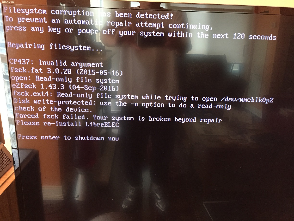

  • I am running a MINIX NEO X8-H Plus
    I have used the Krypton image from 04-18 and it runs great from my memory card
    This is the one from 04-18 that works LibreELEC-S812.MXIII_Plus.arm-8.0.2.img.gz
    I have tried the new image from 05-10 and I get the screen below.
    I have tried all images in the 05-10 folder with same result.
    Even if I let it scan and repair it gives errors.
    Any ideas?
    Cheers.
    • Official Post
    You are trying to run from external media to new system or it is the result after upgrading ?

    I have tried to run the image from a new install on sd card, and I also tried the upgrade path but same error when trying to run.

    For those who have versions of the images 20170510 and they do not run external drives, try replacing the script s805_autoscript at the root of the first partition to this.
    Yandex.Disk
    The audits found that very often the reason for the poor run LE from SD card is poor compatibility of different SD cards with the card reader in the TV box. Therefore, anyone having problems running LE from the external media, we recommend to test the startup with USB stick.
  • I found in the error images with the launch. Please don't use images version 20170510.
    Glad I was not crazy Thanks for working so hard on these images.

    Tried the new 05/13 file. unfortunately same error when booting starts then says corrupted file.
    I tried fresh install, and I tried the update as well. I am using an sdcard as before
    Anything I can do to assist in getting this working ?
