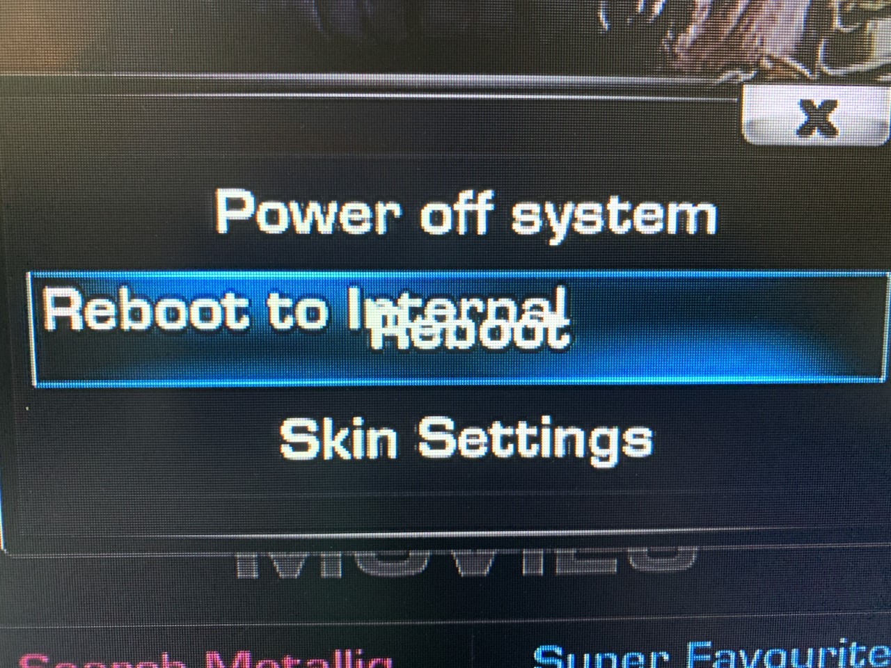

    I am trying to set this up as well, followed above but as you can see in the picture the reboot and reboot from internal are mushed together. So it will only reboot.
    Can you help me space it so it is separated?
