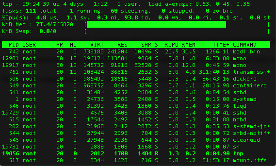

    When I turn on my Raspberry Pi the kodi.bin process use something like 16% of memory (without playing anything). Pass some time this process increase more memory.
    Today, 4 days after I turn it on, kodi.bin are using 31.4% of memory. In this way with more 3 or 4 days my Raspberry will freeze because have no memory available.
    My question is: this is normal? I'm talking about the memory usage without playing anything. There's a way I can get around this?
