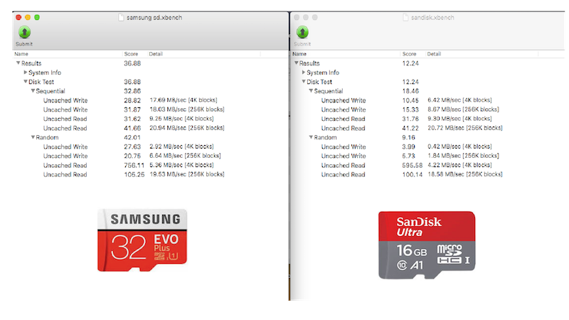

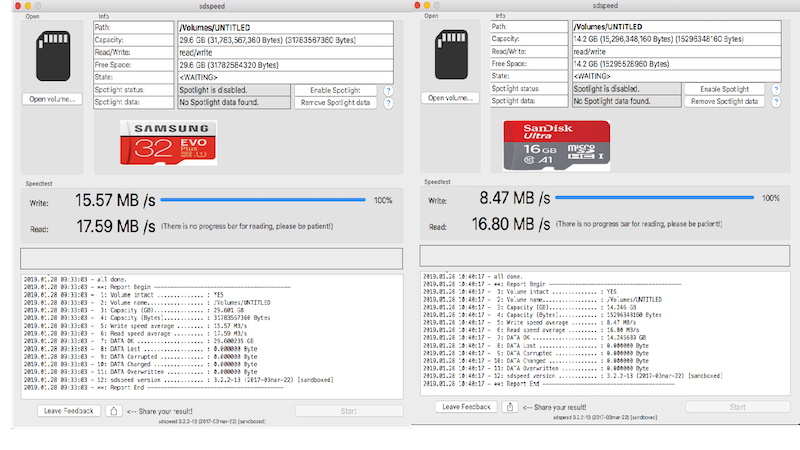

) indeed received a sizable dent, especially for Kodi 18. The default scraper for TV Shows has been changed to TMDB, as there appeared some irreconcilable differences between Kodi and the TVDB website. TMDB has a different scraper, and likely the TMDB background API and server do not have the snappiness that was once available a couple of years ago. It's not ideal, but it does work.SD cards in general have lousy write speeds. It helps to pay more attention to the actual/tested write speeds of SD cards.
Samsung Evo has been a big improvement over my previous Sandisk Ultra SD Cards.
See some pics attached i had kept after testing.
