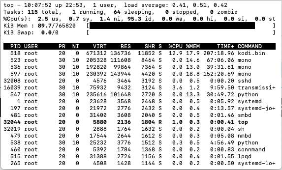

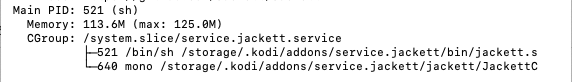

After add, CPU: 233ms shows, but memory don't.

I added this and put MemoryMax=100M in the service, but it still does not show in status.
I'm doing something wrong?
Why is not working?

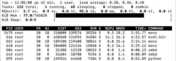

Worked!!!
When you said
at the end of /flash/cmdline.txt
I thought it was to put in the line below, as this did not work. Today I add cgroup_enable=cpuset cgroup_enable=memory cgroup_memory=1 in the end of the line that already exists. So, staying that way
Codeboot=/dev/mmcblk0p1 disk=/dev/mmcblk0p2 quiet cgroup_enable=cpuset cgroup_enable=memory cgroup_memory=1and worked!
