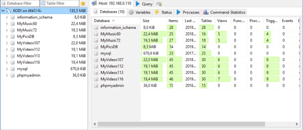

    Just noticed that old databases aren't removed after upgrade to LE9.
    I don't know if the issue is on LE side or on KODI side...
    I'll drop the unnecessary DB's manually...

    Already dumped the old DB's as I have a full DB backup done.
    But as far as I can remember I haven't deleted old DB's manually since I started using MySQL few years back.
