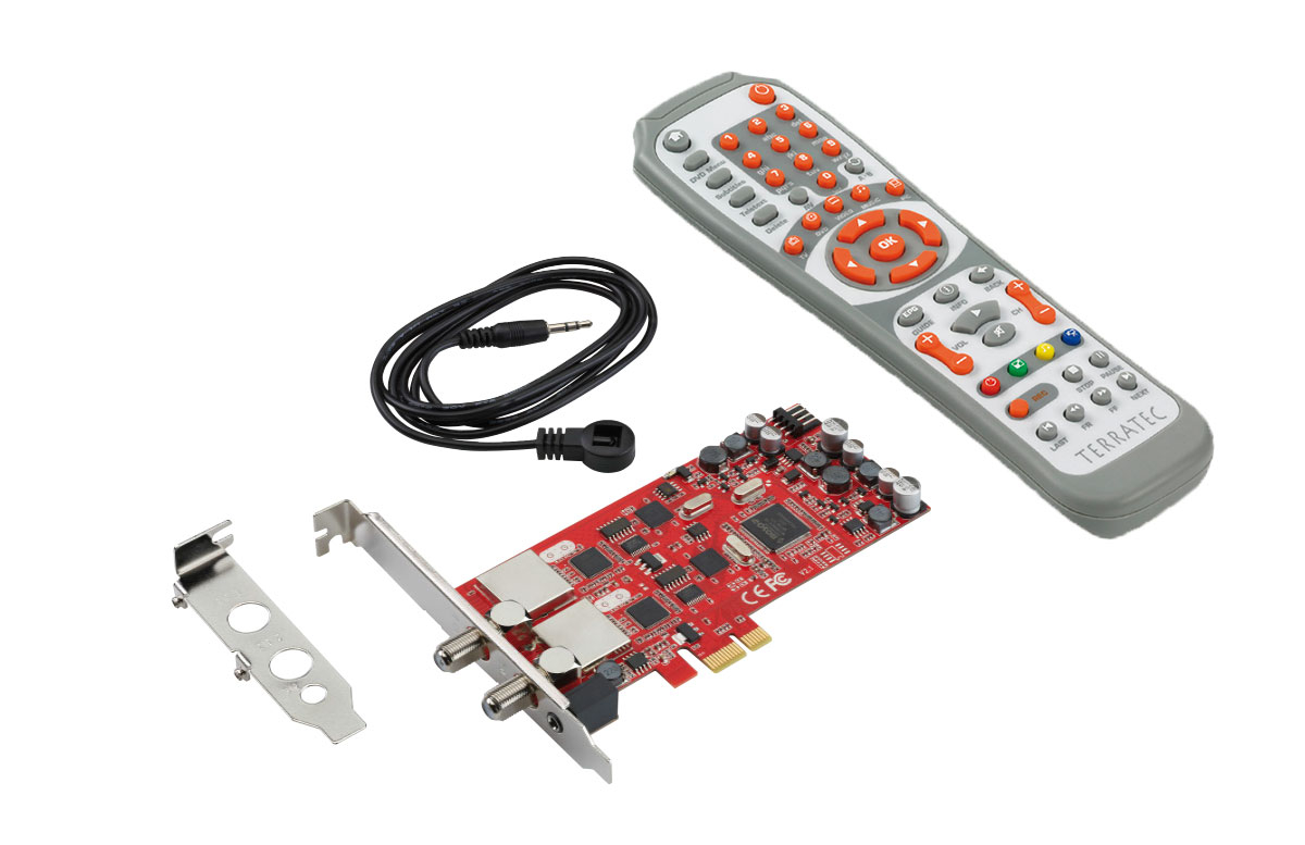

My Cinergy s2 card has an issue with double key events. I basically located the root cause but I don't know how to config what to avoid the double key event issue.
Problem: The card generates two similar ir devices, the only different is rc0 / rc1 resp. the device eventx / event y. ir-keytable sows the following:
