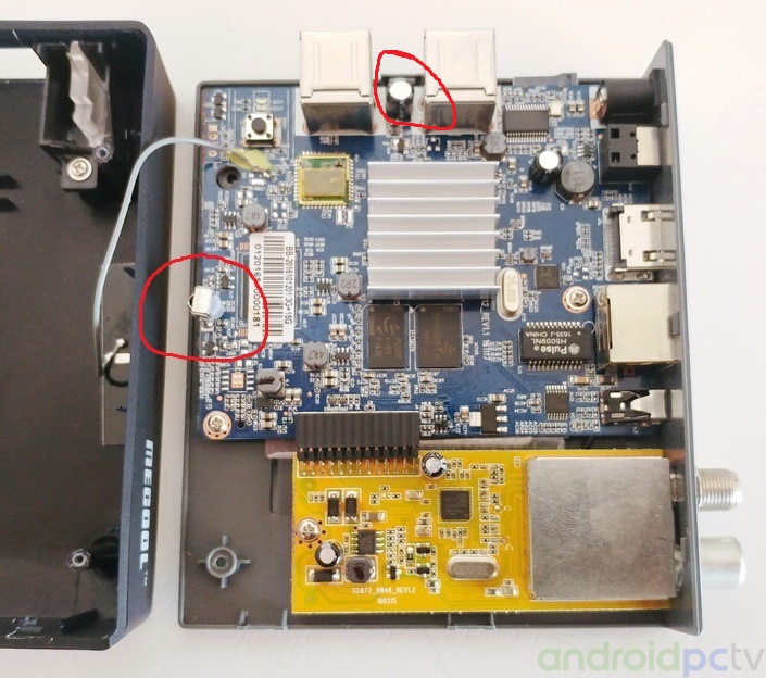

  • blueribb Thanks, that helped somewhat. I put tape over that area in the front and I can tell the signal is degraded because it only turns on/off every 5 presses of the button now. Still getting through though. I'll try more tape.
  • The IR sensor is on the LHS of that photo. The device at the top is a capacitor.
    I know that's a capacitor but behind it (closer to edge) looks like it could be an IR sensor too. You have to look closely.
  • I've never seen a Chinese manufacturer spend money on dual IR receivers for an Android box. If there's one thing you can guarantee about them, it's that they're cheap bastards :)
