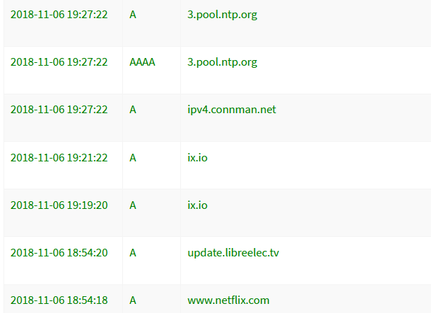

    I have an issue that I might not understand properly and somebody can help me out with it. I like to use my own NTP Server (Router within the Network) to synchronise the clock of two libreelec installations (raspberry pi - LibreELEC (Leia) v8.90.006 ALPHA and tinkerboard S - daily Jenkins builds). I added under Timeserver #1 the local IP address of my router that is providing the NTP information and left #2 and #3 empty.
    I can see now in my Pi-hole that both libreelec installations still connecting to "something.pool.ntp.org" and I do not understand why, since it suppose to take that information from my local source. It works for all other connected devices in my network except libreelec.

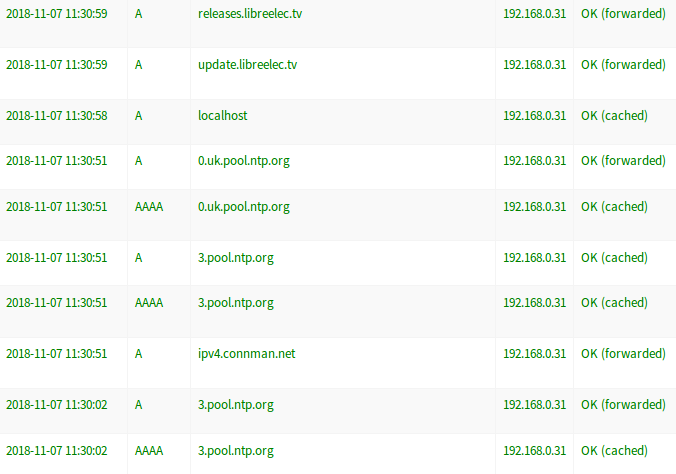

  • I agree. But if there is already a NTP server by your router provided, why not use it.
    Even if I use in all 3 Timeserver fields the same IP address libreelec is still connecting to one of those pool.ntp.org addresses.
    External Content pastebin.com
  • connman/connman.git - Connection Manager
    ^ describes how the NTP logic was changed a while ago to resolve issues with Raspberry Pi and NTP calls being made before the network stack was fully active due to slow loading network drivers. It's quite plausible that the first two NTP attempts on Raspberry Pi fail and the third succeeds; which would result in it being marked as the primary active server. The #1, #2, #3 positions no longer dictate which server is primary. Since all RPi are basically the same the 2-fail, 3rd-pass behaviour would be quite consistent.
