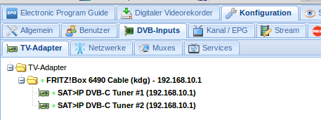

    When I log into Tvheadend with my browser (http://libreelec:9981/) I can only see the integrated cable tuners(?) of my Fritzbox:
    (but as the cable provider has installed a hardware filter, that blocks all TV frequencies, I can not receive any signals via cable - only DVT-T2)

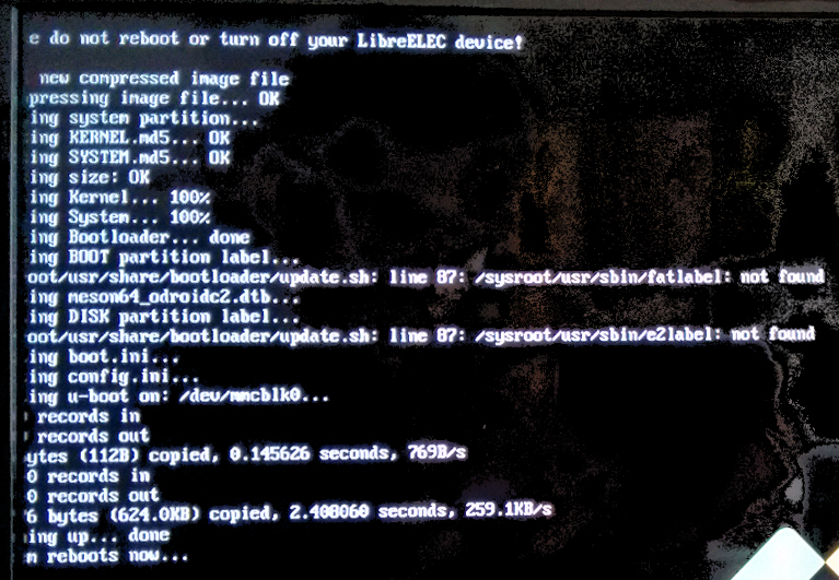

    I have transferred LibreELEC-Odroid_C2.arm-8.90.006.img.gz to /storage/.update. I have also added .nocompat to the folder. The I rebooted and watched the attached screen (TV). Here is the output:
    Step 1: Upgrade looked ok:
    Step 2: Message after reboot: "Starting debugging shell [???] step. mount_storage... type exit to quit"
    System stopped here, so I typed "exit".

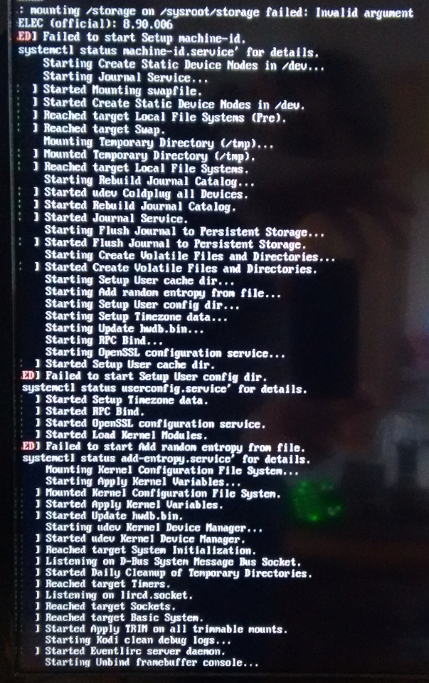

    Step 3: Debug message:
    "mounting /storage on /sysroot/storage failed: Invalid argument"
    "Failed to start machine-id"
    System does not respond, except to reboot via Ctrl.-Alt.-Del.
    No ssh access, only local keyboard and TV-screen ...
    Thanks for helping me to understand this situation
    Fasterix
  • Thanks, the systems is booting again.

    I finally logged into Tvheadend via LAN but still not DVB-stick is offered (only Fritzbox interfaces).
