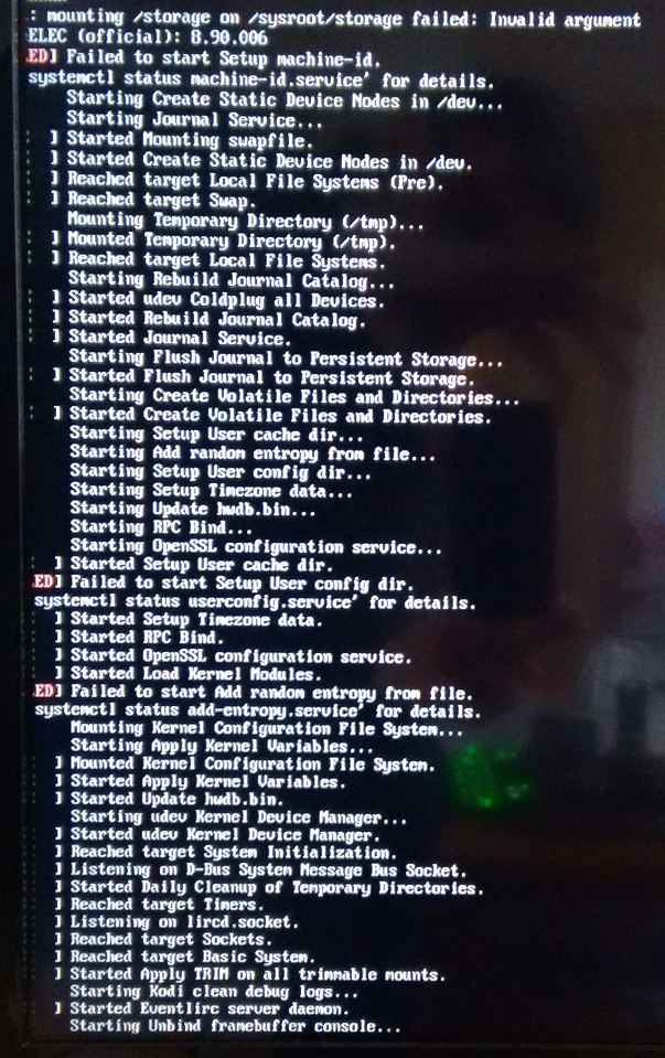

    Hello and thank you for your support,
    I have transferred LibreELEC-Odroid_C2.arm-8.90.006.img.gz to /storage/.update. I have also added .nocompat to the folder. The I rebooted and watched the attached screen (TV). Here is the output:
    Step 1: Upgrade looked ok:
    Step 2: Message after reboot: "Starting debugging shell [???] step. mount_storage... type exit to quit"
    System stopped here, so I typed "exit".
    Step 3: Debug message:
    "mounting /storage on /sysroot/storage failed: Invalid argument"
    "Failed to start machine-id"
    System does not respond, except to reboot via Ctrl.-Alt.-Del.
    No ssh access, only local keyboard and TV-screen ...
    Thanks for helping me to understand this situation
    Fasterix

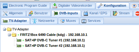

    Hello forum,
    I haven an Odroid C2 and ~1 year ago I followed the instruction of Melibokus to set up a PVR for German DVB-T2. As recommended, I installed LibreELEC-Odroid_C2.arm-8.0.WRX-RB-Media_build.01.img.gz to get my DVB-T2 stick working (Geniatech T230C).
    It worked for 1 year.
    Recently I updated to LibreELEC-Odroid_C2.aarch64-8.2.5.img.gz. The system is booting and basically working, all addons are updated. But I still receive error messages when I activate TV: "No TV adapter available".
    When I check lsusb I receive:
    where Bus 001 Device 006: ID 0572:c689 Conexant Systems (Rockwell), Inc. seems to be the DVB-T2 stick.
    But when I check the kernel modules, I am not sure, if the relevant module has loaded:
    When I log into Tvheadend with my browser (http://libreelec:9981/) I can only see the integrated cable tuners(?) of my Fritzbox:
    (but as the cable provider has installed a hardware filter, that blocks all TV frequencies, I can not receive any signals via cable - only DVT-T2)
    My questions:
    1. Is there a kernel issue that prevents my DVB-T2 stick from working or is it something different?
    2. If it is a kernel (driver) issue, how could I solve it?
    3. Or should I go back to LibreELEC-Odroid_C2.arm-8.0.WRX-RB-Media_build.01.img.gz which contains the necessary support for my DVB-T2 stick already?
    Thanks for your help
    Fasterix
