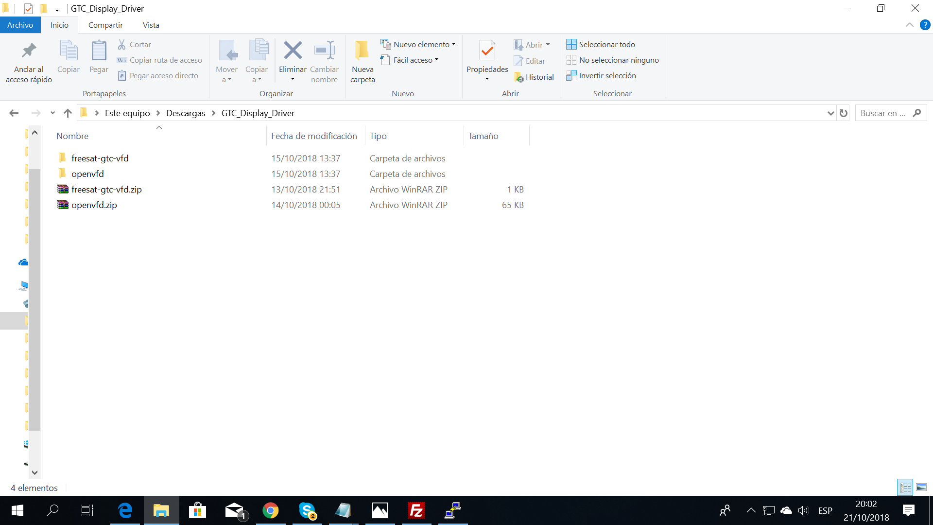

  • I do not understand these steps
    2- Unzip and copy folder into your GTC in /storage directory
    3- chmod 755 to all file into the display folder
    2 --Copy the GTC Display_Driver folder, in the original storage directory android
    • download driver package
    • unzip the package
    • copy with ftp all files from your pc to your gtc
    • After you copy files from pc to gtc you must connect to the console of gtc with a ssh connection
    • with ssh connection you are inside your box and can go to directory wher you ftp the files (example storage directory)
    • do permissions 755 to all files (chmod 755 install.sh, openvfd.ko, OpenVFDService, stopservice.sh, test_led.sh, uninstall.sh)
    • launch command from gtc shell sh install.sh
    • reboot gtc and you have display working
    Hope now more clear for you.

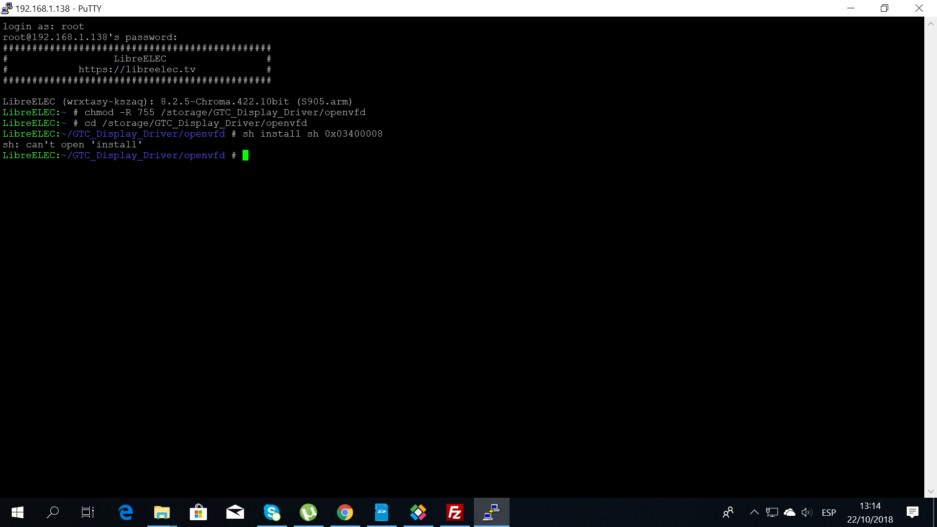

    • forum.libreelec.tv/core/attachment/4311/download driver package
    • unzip the package
    • launch command from gtc shell sh install sh 0x03400008

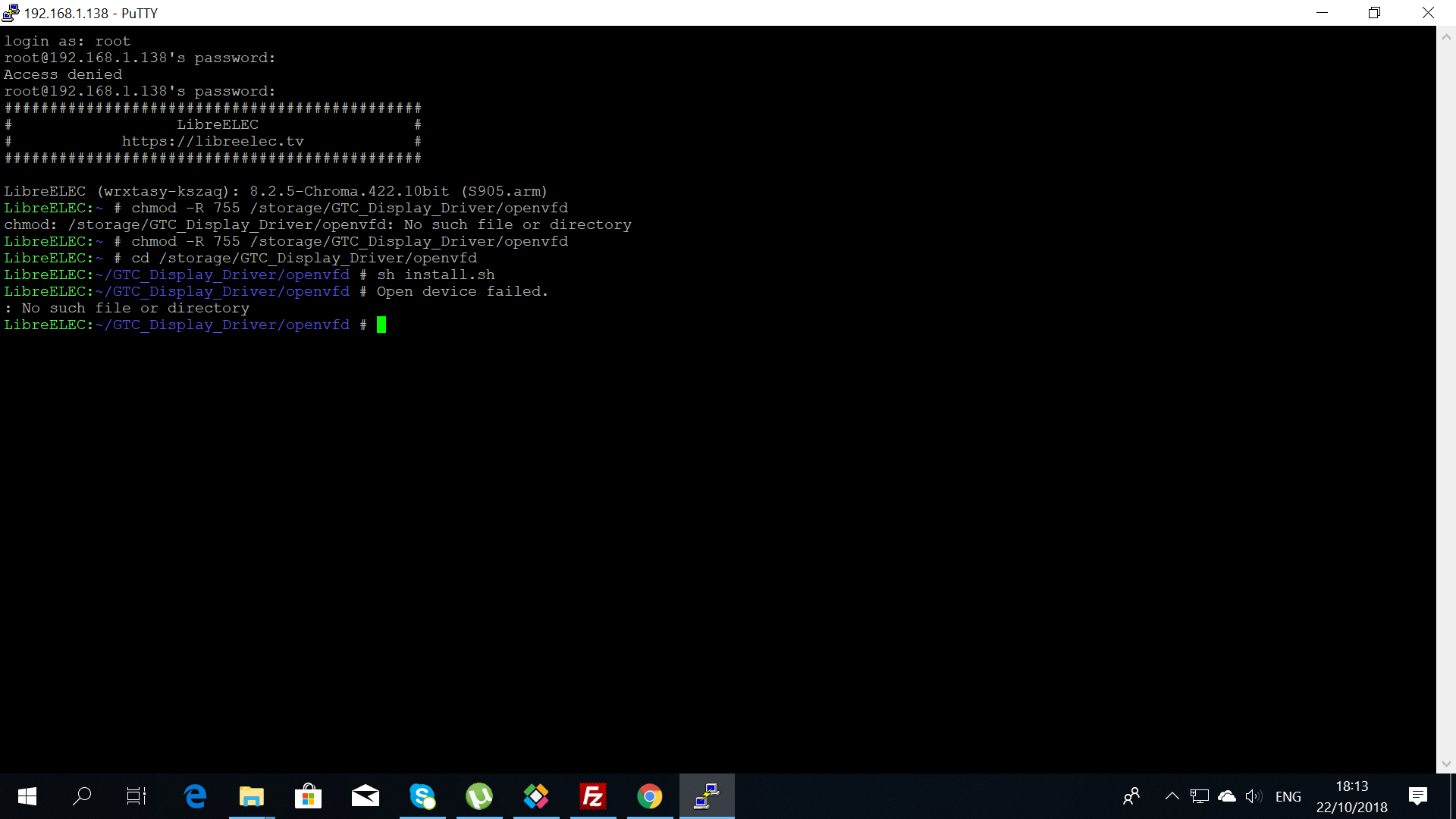

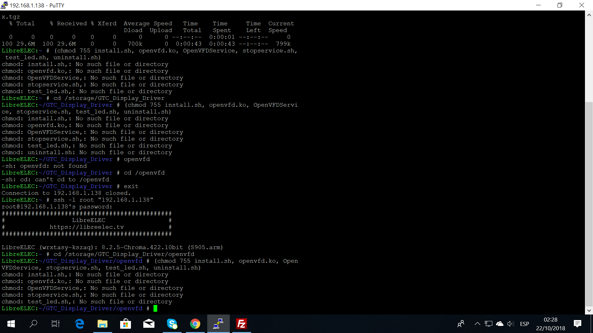

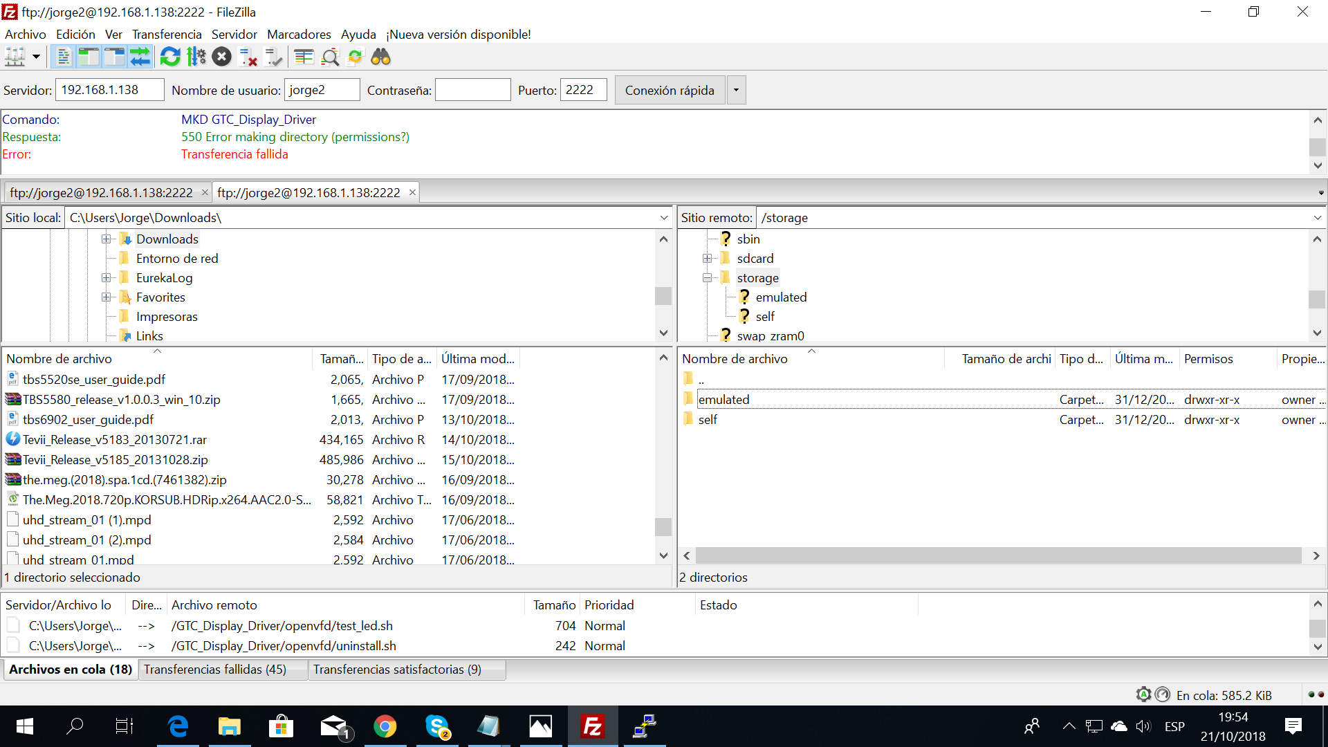

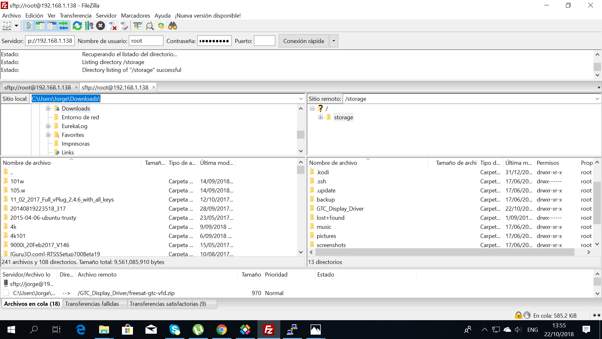

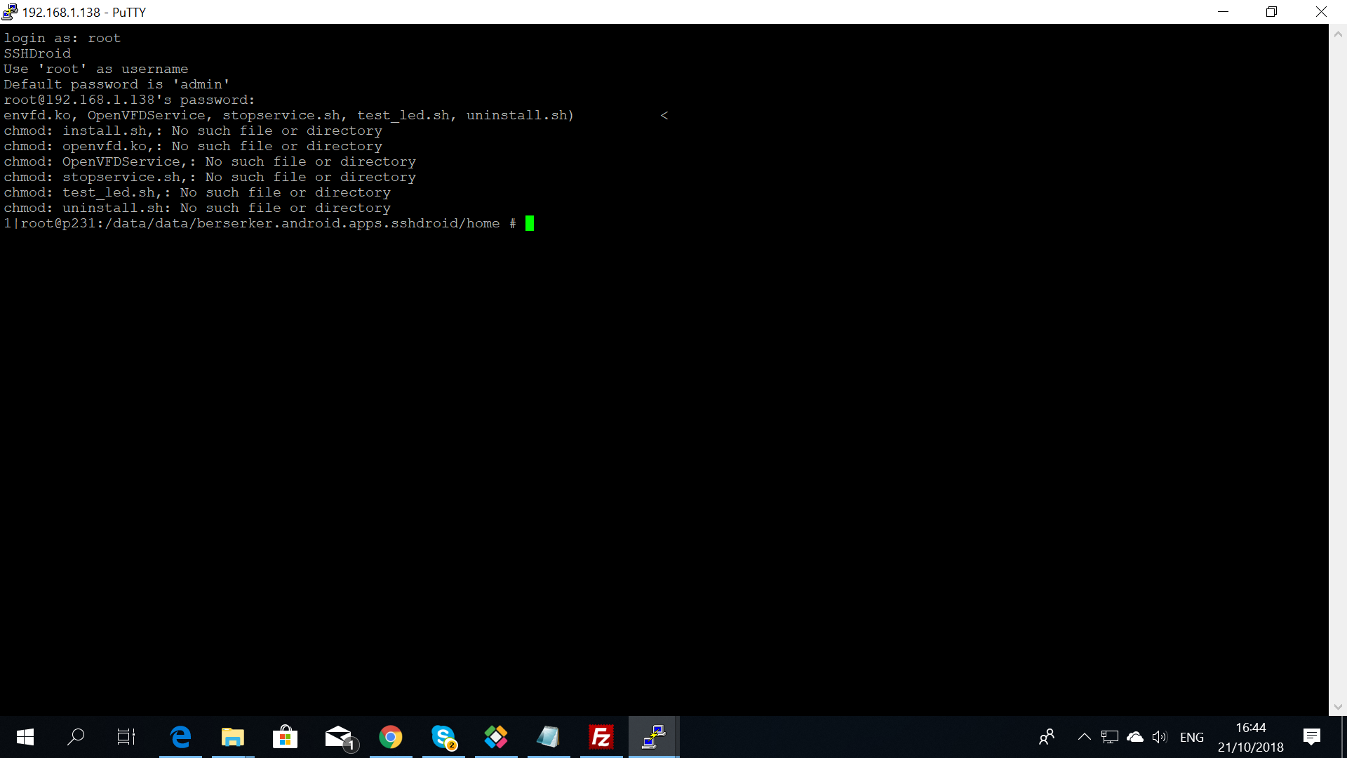

    it seems that it is a little more complicated than it seems, copy the file that unzipped in storge with es explorer since with filezilla it is not possible to error .....550 error marking directory permissions
    then e written the command in putty console

  • espaun
    if you have the files in /storage/Gtc_Display_Driver/openvfd
    you need command
    chmod -R 755 /storage/Gtc_Display_Driver/openvfd
    now if all ok go into openvfd directory with
    cd /storage/Gtc_Display_Driver/openvfd
    and now you can start
    sh install.sh
    reboot the box.
    This procedure work only with libreelec 8.2.5.
    Edited once, last by linch (November 19, 2018 at 10:29 AM).
