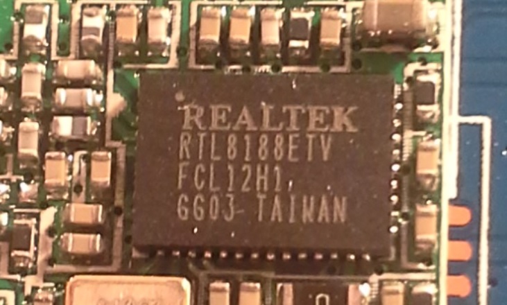

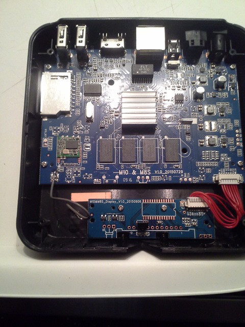

    here is a pict of the pcb
    M10&m8s pcb with 2Gb / 8 Gb and a s812 and a realtek rtl8188tve wifi on it can i put this built 2 on it?
    its working with android now but internet keeps faling out and no wifi mmmmmm
    any idea's
