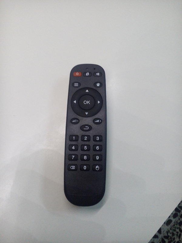

    I tryed this remote.conf without success. My M8 has 2 years too, but the remote is almost identical, except for the four buttons around the arrows that are flipped. Here is a pic.
    Hi that your buttons are flipped is correct.. i flipped mine myself.. as i have used this remote for an ther box...
    Be sure you put the file from codesnake in /storage/.config then reboot and all should be okay.
