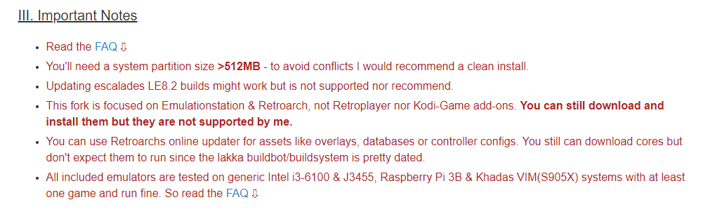

    Well basically hopping between the builds should work so install my build to have a proper partition then install the vanilla LE and update to my build once you have your addons. I'm currently building a generic build and probably will upload it tomorrow if everything works fine.

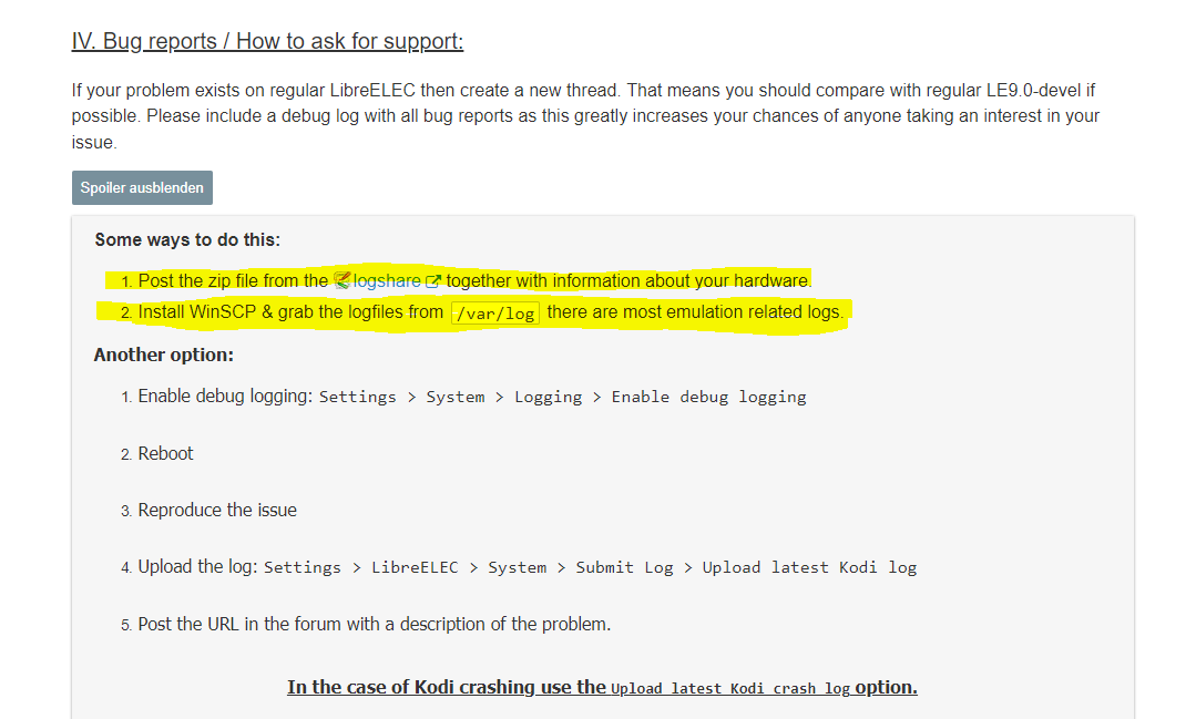

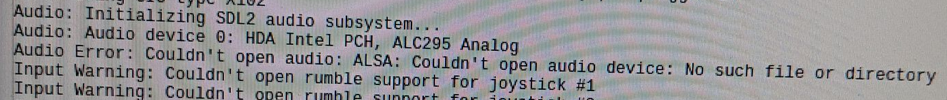

    Logfiles...:/ anyway I guess you haven't set the audio device in the addon, did you?
    Aw. So I cannot update my official installation of LE 9.0.1 to yours using the update channel? Have I to do a fresh install with yours? Doesn't the update resize the existing partiton and write the new data on it?

  • Logfiles...:/ anyway I guess you haven't set the audio device in the addon, did you?

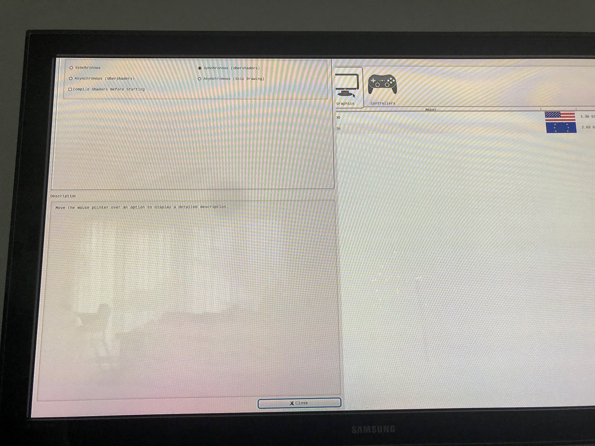

    Ya, ok. My bad... Games are loading now and sound is working but I can't configure the controller because the Dolphin menus are not fitting on my TV screen so I can't see all the options. Probably a Dolphin thing and not an issue with your build though.
  • Ya, ok. My bad... Games are loading now and sound is working but I can't configure the controller because the Dolphin menus are not fitting on my TV screen so I can't see all the options. Probably a Dolphin thing and not an issue with your build though.
    Navigate to the config addon as described
    LibreELEC 9.x RR [ Emulationstation | Retroarch | Pegasus | DolphinQT | Moonlight | Chrome | Spotify | MakeMKV ] disable autoscale in the Qt section and play around with the manual scale factor. If this does not help read the FAQ and configure xorg.conf according to your DPI.

  • Well what does the Dolphin logfile say if it doesn't come up?
