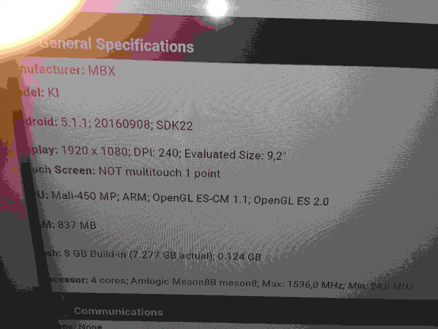

  • Hi,
    Android TV Box labeled MXQ / S805 ...please see the picture for details ;)
    It was Android 4.4 or so - I switched to Android 5.1.1 but this is really slow!
    So i wanted (like on annather box) boot Libre ELEC from USB..But i try 15 *.img BUT
    - I cannot boot (Win32manager/USB Burning Tool didnt work on win10..))
    So... can annyone tell me how i can use Libreelec??? (to as stand allone ???)
    thx dmog
