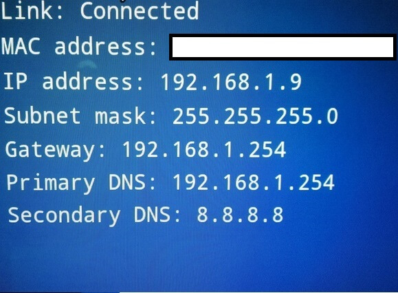

    here ip setting for 8.0 :

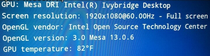

    my GPU :

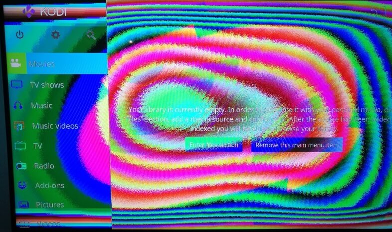

    I installed a 8.2.3, If I reboot sometime it will work well and sometime :

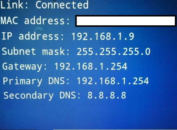

    btw : my intenet is working fine with 8.2.3 (same ip conf as other screenshot)
