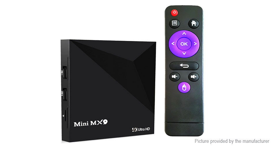

Hello, Guys im new at this community right now im learning to unbrick and update firmware from RK3229 Android TV Boxes.
but find out a problem after updating and thats the IR remote its not working, i read the whole forum looking for a remote.config for my Mini MX9 Android Box, without any luck
do you know where can i find or make my own remote.config to share it here?
i really need to make the box work.
regards.
Note: Also i have to tell you i have more Mini MX9 that are working well, i tried to extract (copy) the remote.config file from a mini mx9 box working, but didnt find it in etc folder, also wasnt able to find any file named remote.config, remote or controller, where do you think i may find this file to copy and paste it in the other one?

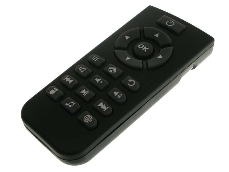

And what is the driver for the default remote control (K1 plus S905 see picture below) to connect to as a second remote control?

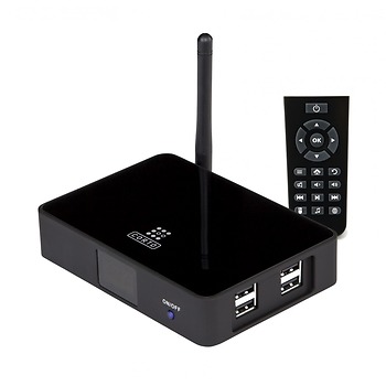

Hello Guys,
Can someone post remote config for Corto Amlogic box?
Thanx in advance.
Hello Guys,
Thanx in advance.
did you share the remote.conf file to me ?
you can find this file in your flash disk in libreelec sysytem.
I can help you to build the romote file .
I didn't.The box was stuck on boot logo so I had to flash with CMX rom I found on net and I don't have original remote config file.I really appreciate your will to help me.If it can be build from CMX Rom remote config file it would be great.
I'll you file as soon as possible.Thanx a lot.
firstly , you have to use libreelec 8.2.3.1 edition or other 8.x systems.
and load your box .
setup it .
and then go into the flash disk , you will find the remote.conf file.
finally, send to me .
