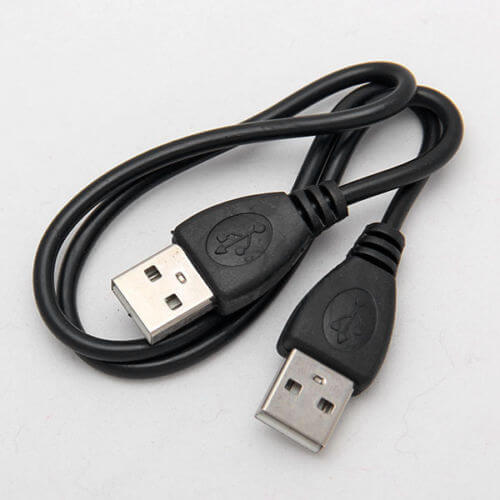

    Link #2,273
    I power it via USB HDD input on my tv with no issues. Cable required.

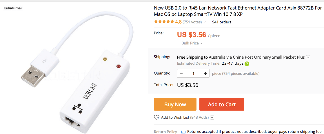

    I ordered an ethernet adapter with Asix Chip. See what happens when i get it.

  • Why not gigabit ethernet adapter
    My home is Cat5 wired.
