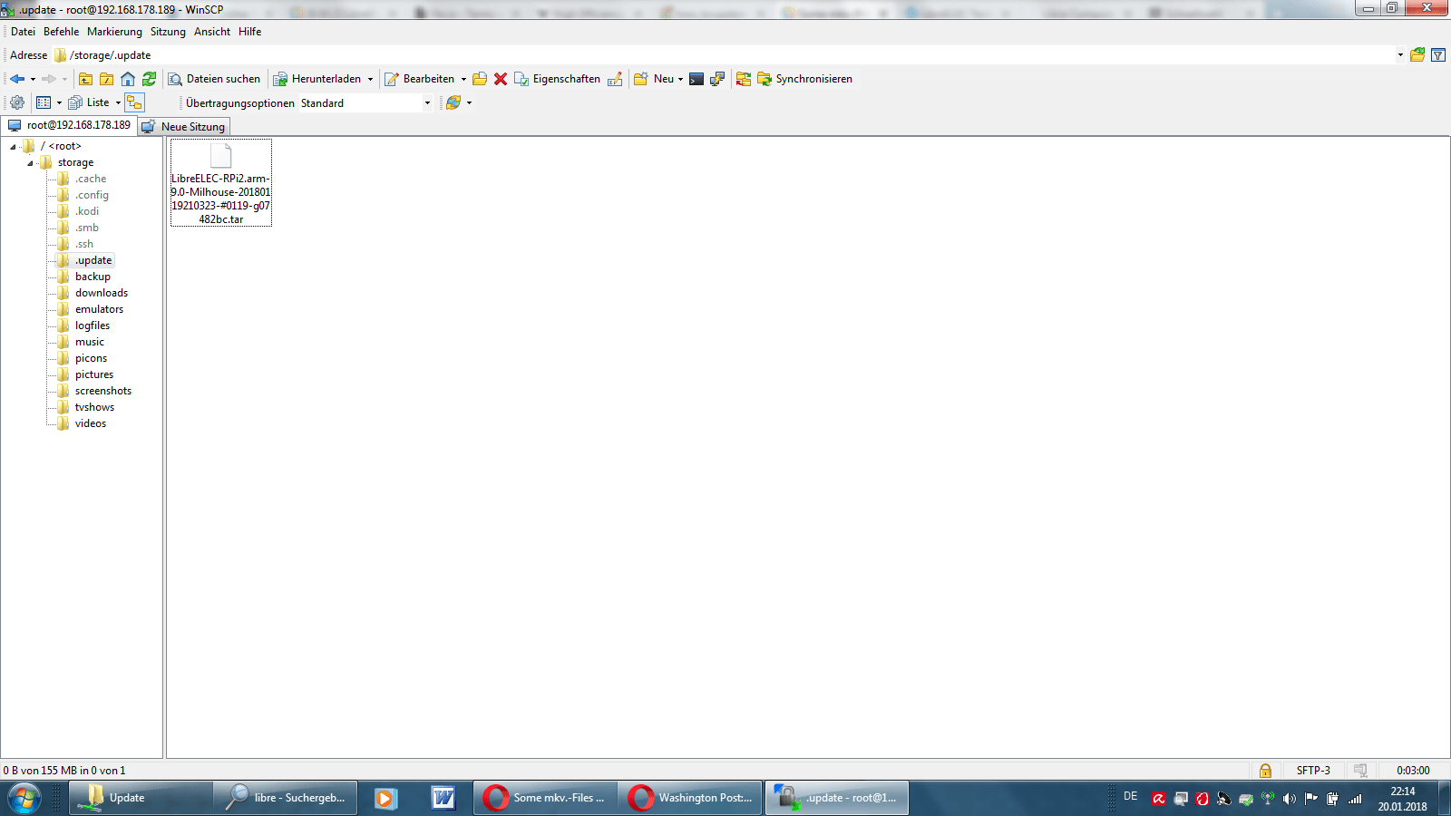

  • Thanks again for helping me. Sorry for asking dumb questions, but...
    - I created a backup
    - I downloaded the newest build, realizing it's not a stable version etc... and copied it into the update folder
    - I rebooted
    Didn't update though, still on the 8.x version number.
    What could I have overlooked?
    [edit: added screenshot showing update file in folder]
    [edit 2: I use berryboot fyi]
  • By following the instructions on the page linked above I was successfully able to update my system so that it's running LibreElec 9 / Kodi 18 now :cool:
    Sadly nothing has changed in regard to my problem with playback. Some files still crash the system ;(
    Even so I've learned quite a bit tonight, thank you smp and Klojum. I'd greatly appreciate any further help.
