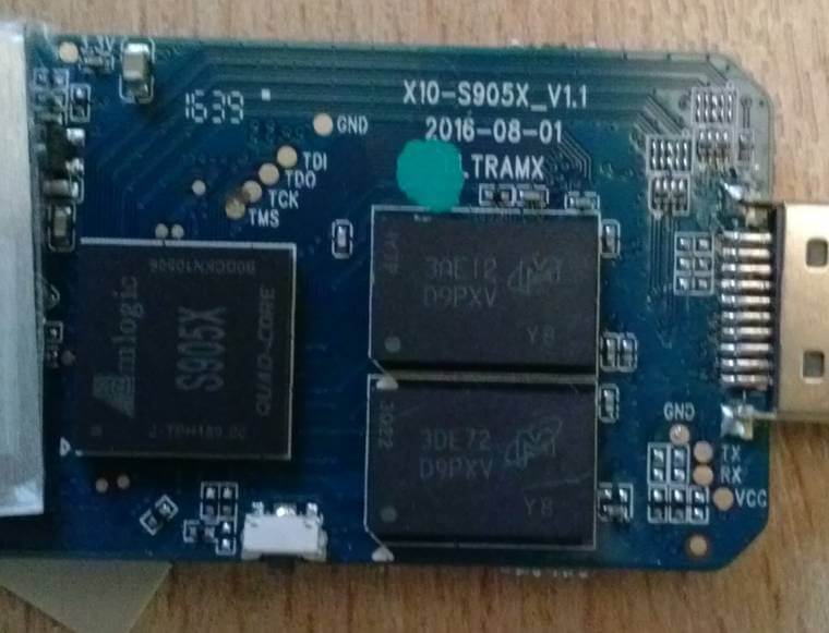

    I am the owner of this android stick. is has 1 gb ram 8 gb rom
    on the MB is printed:
    X10-S905X_1.1
    2016-08-01
    TRAMX
    AMLOGIC S905X
    3AE12 ram?
    D9PXV ram?
    The Coowell V5 has one USB slot and one slot for miro sd cards.

    I have included A picture of my mem chips maybe this wil help
    Greetings Herman:)
