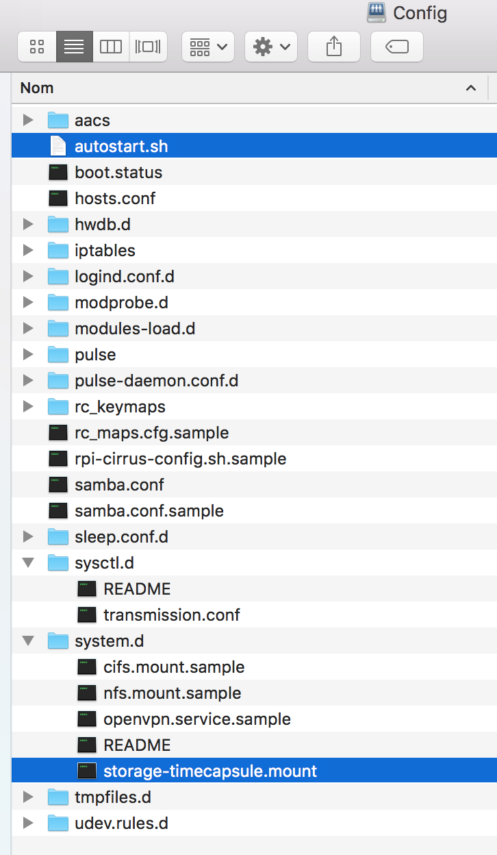

  • Save that ^ as /storage/.config/system.d/storage.timecapsule.mount then "systemctl enable /storage/.config/system.d/storage.timecapsule.mount" and reboot, and the local mount to the device should be available to add as a new source in Kodi. It appears to be stable for me over a period of several hours. If 'mount' works the issue appears to be in smbclient or how Kodi interacts with smbclient.
    Fenderman You will need to rescrape content to the library as all paths to content will change, but at least it works. It is technically possible to update the DB paths but that requires some sqlite SQL skills and I never bothered to learn those. I'm sure there's a howto somewhere.
  • When the TC access dropped from LE for me (should have mentioned it is on an RPi3), I was also trying access from Win 10 (1703) which would then not connect again until the TC was restarted, restarting LE would not help. The only difference was my mount file based on the existing sample file did not contain the additional explicit options "sec=ntlm,vers=1.0" which maybe made some form of difference to it's resiliance?
  • Adding the following autostart.sh to the .config folder did also work for me
