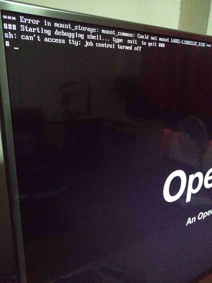

    Used the latest Libreelec device tree update for my box with your openPHT file. Burn it to my micro sd card and install. The install fails. Tried many times.

  • Me too having problem with fresh install (error "... can't access tty ...").
    But update from kszaq's build is ok.
