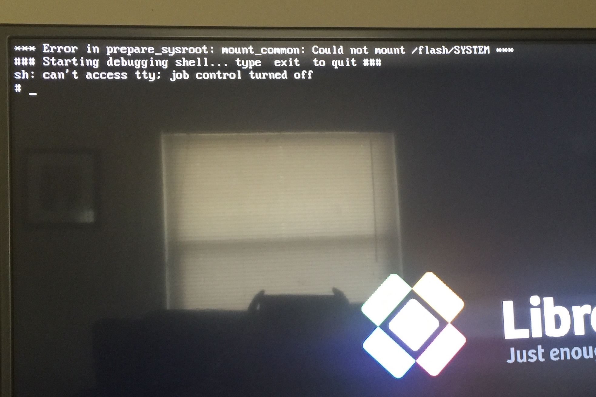

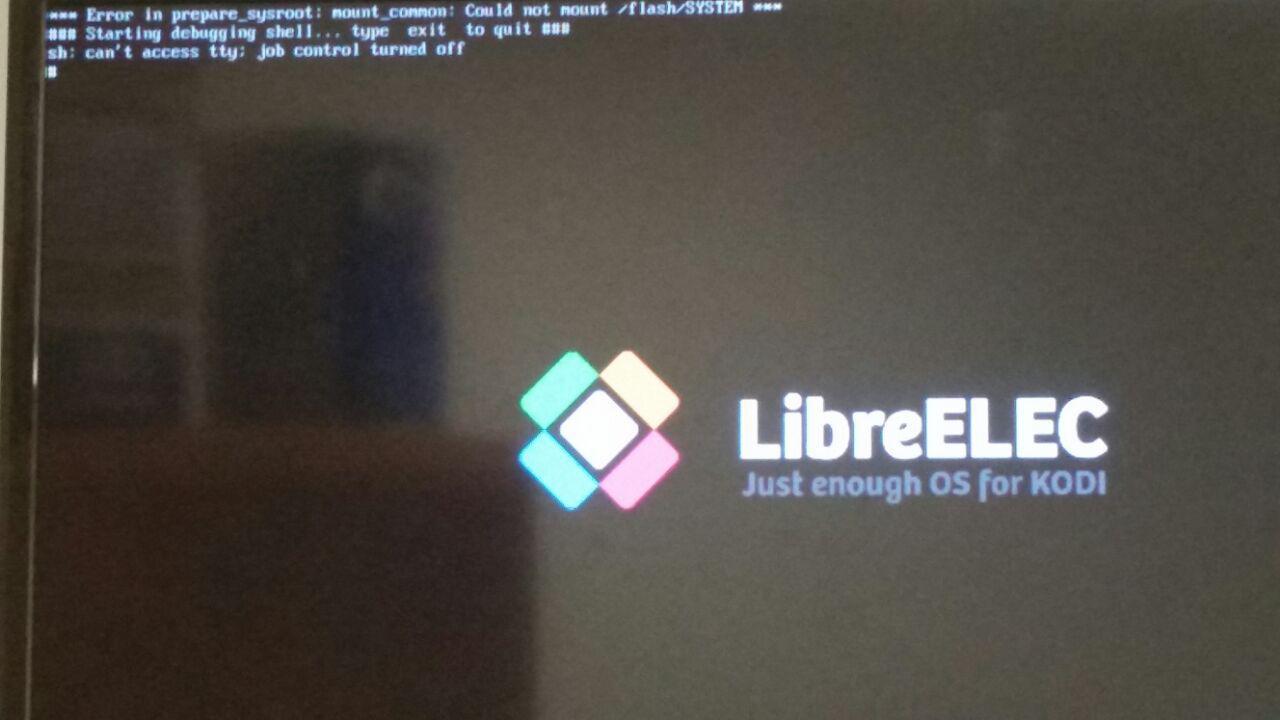

  • Her man use this Ember revert back to Android zip. MEGA,
    Apparently flashing OE did not help your Cause. Try flashing LibreELEC after reverting back to Android. 3times a charm!!!
    Sent from my SM-G900T using Tapatalk
    i think my box is done. tried flashing it with that file u provided it just went to a grey screen for second then to a balck screen and it wouldnt do nothing........ it wont go into recovery blue stays on but nothing comes up.
    edit ok i was able to go back to ember. phew......
    Edited once, last by Smilez (August 30, 2016 at 9:32 PM).
  • i think my box is done. tried flashing it with that file u provided it just went to a grey screen for second then to a balck screen and it wouldnt do nothing........ it wont go into recovery blue stays on but nothing comes up.
    Try Re Flashing LibreELEC Maybe now it will install...
