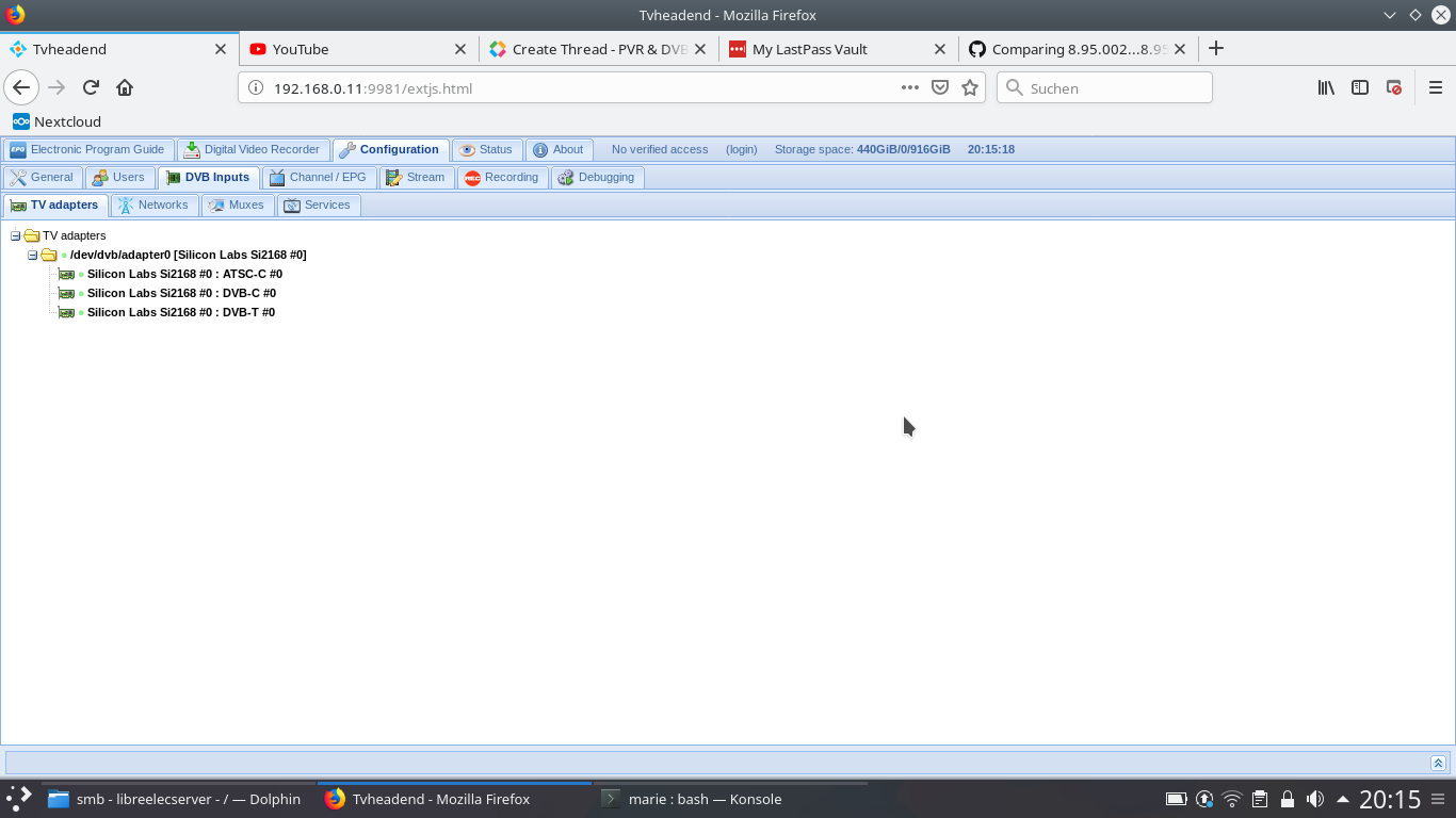

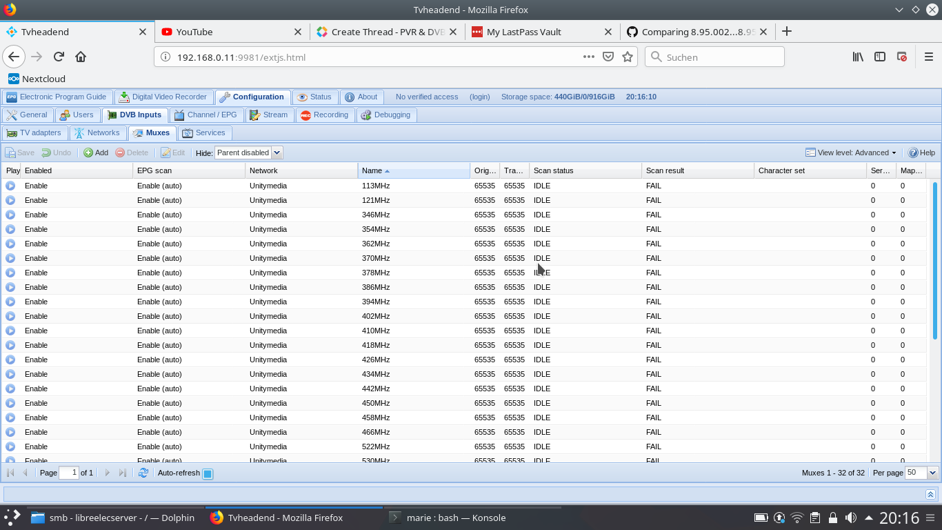

    i recently updated our Libreelec HTPC to version 9.95.3 and now my DVB-C usb-stick (Mygica T230 DVB-T/T2/C) is unable to find any channels anymore.
    The stick is recognized as "Silicon Labs Si2168 #0 : DVB-C" and everything works well except the scanning for new channels.
    Every result in the muxes tab is "FAIL" even tho it worked really good before i upgraded.
    I have tried all drivers, but none of them works. Every time the card is listed 3 times (DVB-C/T and ATSC-C) but the scan for new channels fails.
    I attached a few screenshot and my recent logs to make my problem clearer.
    Maybe someone has an idea why it doesn't work. I would not like to downgrade to LE8 again.
    Logs: http://ix.io/1yht
