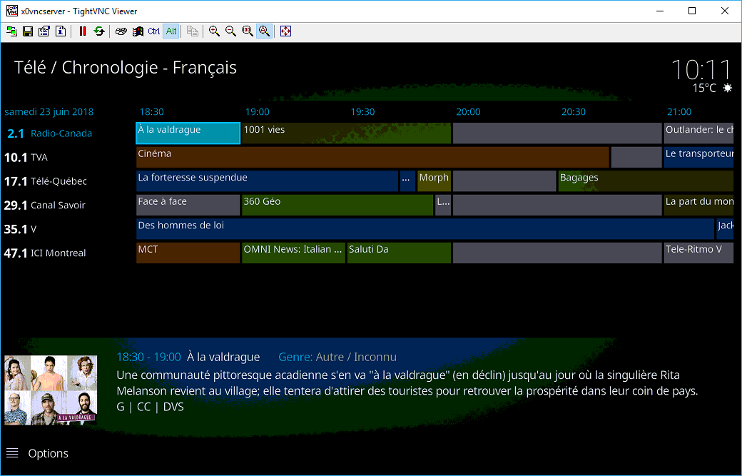

    Hi!
    Since a few weeks, sometimes in the EPG there are empty schedules somewhere in the middle of the EPG.
    "Zip code" used : h2z1r1
    I don't know what to do to find the problem. Otherwise, the rest is fine. It seems that it often happens around 8pm, again I don't know why.

    I went into tab "CONFIGURATION -> CHANNEL/EPG -> CHANNELS". There I added the EPG source zap2epg to the channels that didn't had it already. It took awhile, but this morning every channels have nice EPG data.
    Thanks again for your quick and super useful support! Your work is awesome ! :thumbup::thumbup::thumbup:

    Now, I have another problem. It's even bigger for me. Looks like I don't get ALL the programmes in my EPG. I did a small screenshot to show you : 2017-11-13_0825
    Can't be really sure about what's happening. Looked at the xmltv.xml file and saw some accentuated characters that looks scrambled in the missing programmes. You may have to encode them before writing them to the file. (in zap2xml Windows version I know there is a commandline "-e" or "-E" that you can use to do that)....

    Ok. I think that looking at the debug.txt file of TVH I found the problematic piece. Looks like zap2xml addon is working hard, very hard. While the EPG is working fine, there's something in background that is not working fine.
    Last 1000 lines of debug.txt : HSiS
