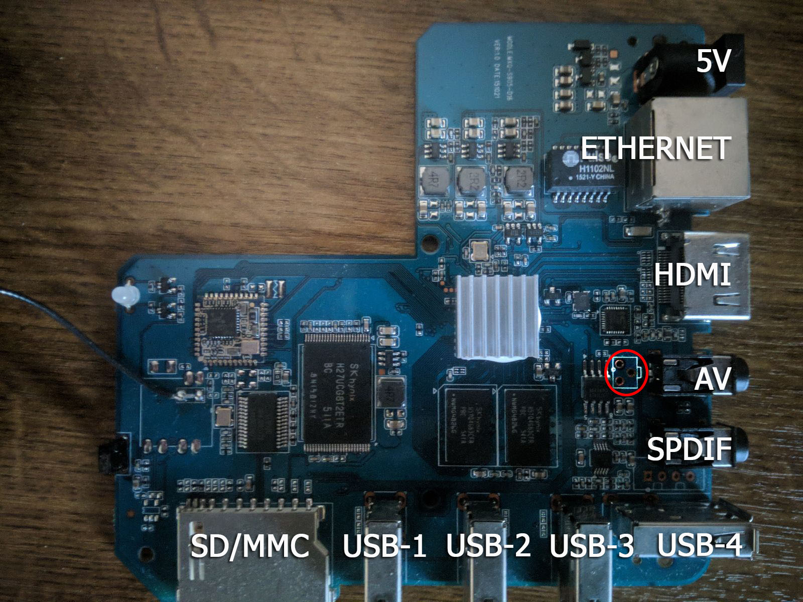

    Well, I asked a friend who does photography as a hobby and she said I have to use external lighting when I take photos of objects close up. And that is what I did for my second photo, placing 2 light sources on each side and disabling the flash completely.
    I tried dtech's image, with both dtb files he provides, and it does not boot. I think I said it earlier and you said it is because of the new boot mechanism used by le 11 on amlogic socs. And I do not care about bt.
    If those holes are really for a reset switch, I may ask the neighbor to solder one for me there.
    The reason I do not want to quit already is because I really want to get a tvbox with kodi 19+ (= python2 addons will die completely by the end of 2023 imho) to that family I have mentioned in another thread (poor family of 5, with 3 kids aged from 3 to 9yo). It keeps them occupied when their parents are at work.
    Right now they have the all black mxq with s805. Unlike the mxqpro4k, that one has a reset button inside the av port and installing dtech's image of le 9.2.x was very easy.
    I never thought taking photos of something would be so annoying. This is the last photo I post. It takes me more time to really capture a clean one than to edit it on photoshop. And this time I had to use external lights so that the camera flash does not reflect on the board itself :(
    https://imgur.com/a/GkEZmPJ
    Compared to the one above, this is flipped horizontally, so the side with the hdmi and other ports is now on the left. The usb and card slots are at the bottom like before.
    That is what I am saying. The tvbox has no reset button at the end of the av socket. It is more than obvious from those 3 tiny holes that indicate a missing switch at that spot. And I know that since 2 years ago that I first decided to install something in it, I did not learn it yesterday that I took it apart!
    Do you mean the one right next to the hdmi port, labeled as "av"? As you can see on my photo above, there SHOULD be a button over there but it is missing. It just has 3 tiny holes there. And that is the root of all my issues with it.
    Moreover, the fist thing I noticed on xda's photo was that small "bump" that is inside the spdif port, but my hopes were wiped when I saw the board on my tvbox.
