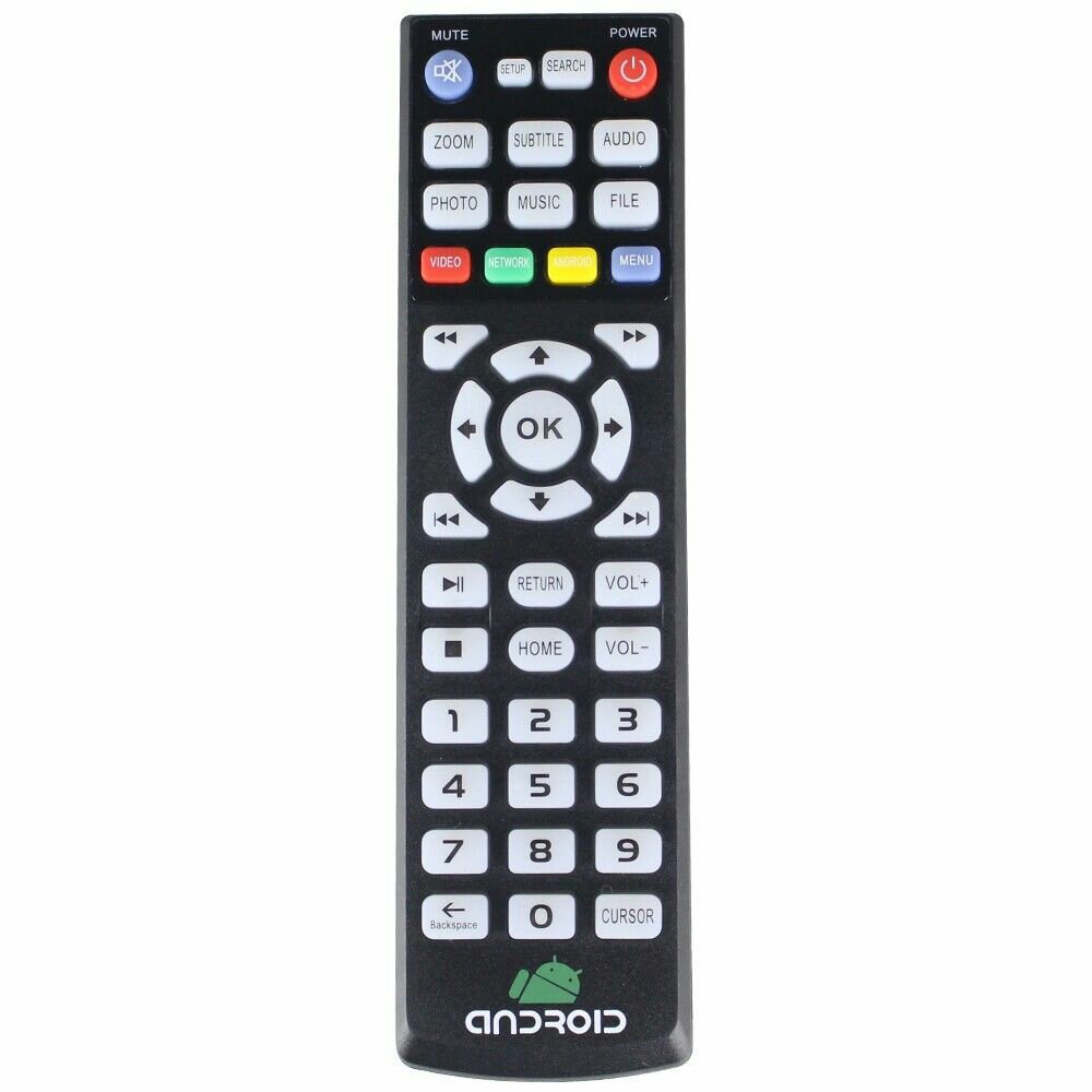

    I tried above but lost the ability to use the stock remote.
    There was a remote in the Harmony database that had additional features/buttons that you were asking for and it matched the stock remote basic buttons. After several hours of tweaking with the remote.conf I got it working.
    LibreELEC
    Sent from my SM-G935V using Tapatalk
    MX2 remote.conf: remote.conf
    Thanks,
    I also grabbed one from a firmware, which didn't help, I had to remap all the buttons anyways.
    Here it is with the additional buttons added and mapped to work with the common T95X remote. Harmony DB "GBox MX2" had a small issue with ChapterUp. Other than that will work fine.
    I also added use of the
    SETUP as AudioDelay
    APP as Subtitle
    Return as back button.
    Mute as Info
    Can someone post their remote.conf for a MX2 or similar device that has the additional play, pause, ff, rr.. working
    Like this remote?
    It uses the same ir as the standard remote, just with a few extra functions and harmony has the codes saved for their remotes
