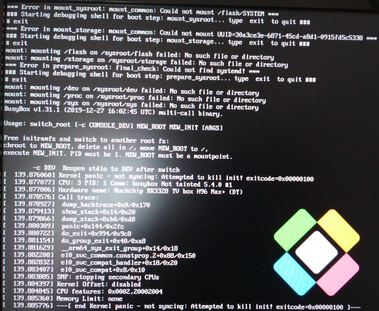

    If you have any working system on the SD card that starts normally, you will be able to check the LE. You need to try to replace the u-boot in LE, on the version with a working SD card. You need to perform a few additional steps when preparing an SD card.
    With the original u-boot:
    1. The system boots,
    2. There is a redistribution of the memory card
    3. Restart
    4. The logo is displayed for a few minutes
    Then cyclically repeats step 3, 4.
    With changed u-boot - error as in the photo.
    I also add a log of TTL
    New image 20200406.
