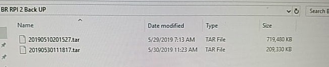

    When I did my first Kodi Tar backup with the LE program config app, the first backup was 1Gig about, I did 2nd backup this month and that one was 200Mb's which is weird. I did not change anything, or delete or add anything, yet the tar file is much smaller. Am I missing something here ?
    I did this on 2 of my RPI 2 and both have done much smaller backups. I did try comparing both tar backups and other then size, they look almost the same at quick glance. The only thing I can think of which might be possible is, the first back up I did on Kodi 18.1 and 2nd one was does after I updated to kodi 18.2, I know sometimes when we update it might disable some addons, but I only have a few addons anyways.

    Well still weird as on both RPI 2 first back ups I did they were both over 1 Gig and the follow up are around 200 MB's
    While I have you guys here, on another note. When I did my first Kodi Tar backup with the LE program config app, the first backup was 1Gig about, I did 2nd backup this month and that one was 200Mb's which is weird. I did not change anything, or delete or add anything, yet the tar file is much smaller. I could of sworn the first back up asked all the settings I wanted to back up and I check marked them, but for the life of me I don't see that now. Am I missing something here ??
