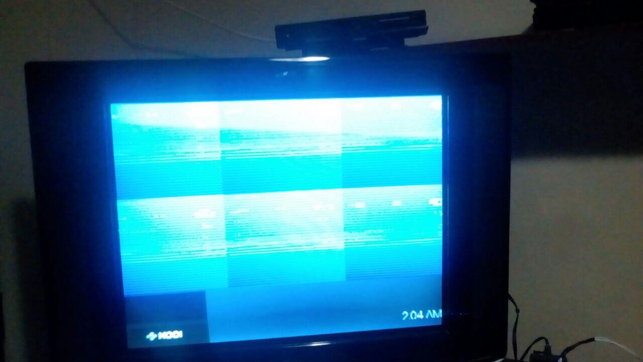

still cant make it work on mine...funny part? retroarch on android works without any issues!
the best would be porting emulationstation to android.
So after my long way on libreelec to make it boot now i gotta fix something!
i need to fix framebuffer to make retroarch display perfect!
im using 480cvbs television resolution !
and ive been trying such things like:
bpp="16"
obpp="32"
# Set framebuffer geometry to match the resolution
case $hdmimode in
480*) X=720 Y=480 ;;
576*) X=720 Y=576 ;;
720p*) X=1280 Y=720 ;;
*) X=1920 Y=1080 ;;
esac
fbset -fb /dev/fb0 -g $X $Y 1920 2160 $bpp
fbset -fb /dev/fb1 -g $bpp $bpp $bpp $bpp $bpp
echo 0 > /sys/class/graphics/fb0/free_scale
echo 0 > /sys/class/graphics/fb1/free_scale
echo 1 > /sys/class/video/disable_video
But i just cant make it work, kodi works flawlessly but emulationstation and retroarch doesnt!
Any tips on how do i use fbset to make it 720x480 ntsc 60hz refresh rate?

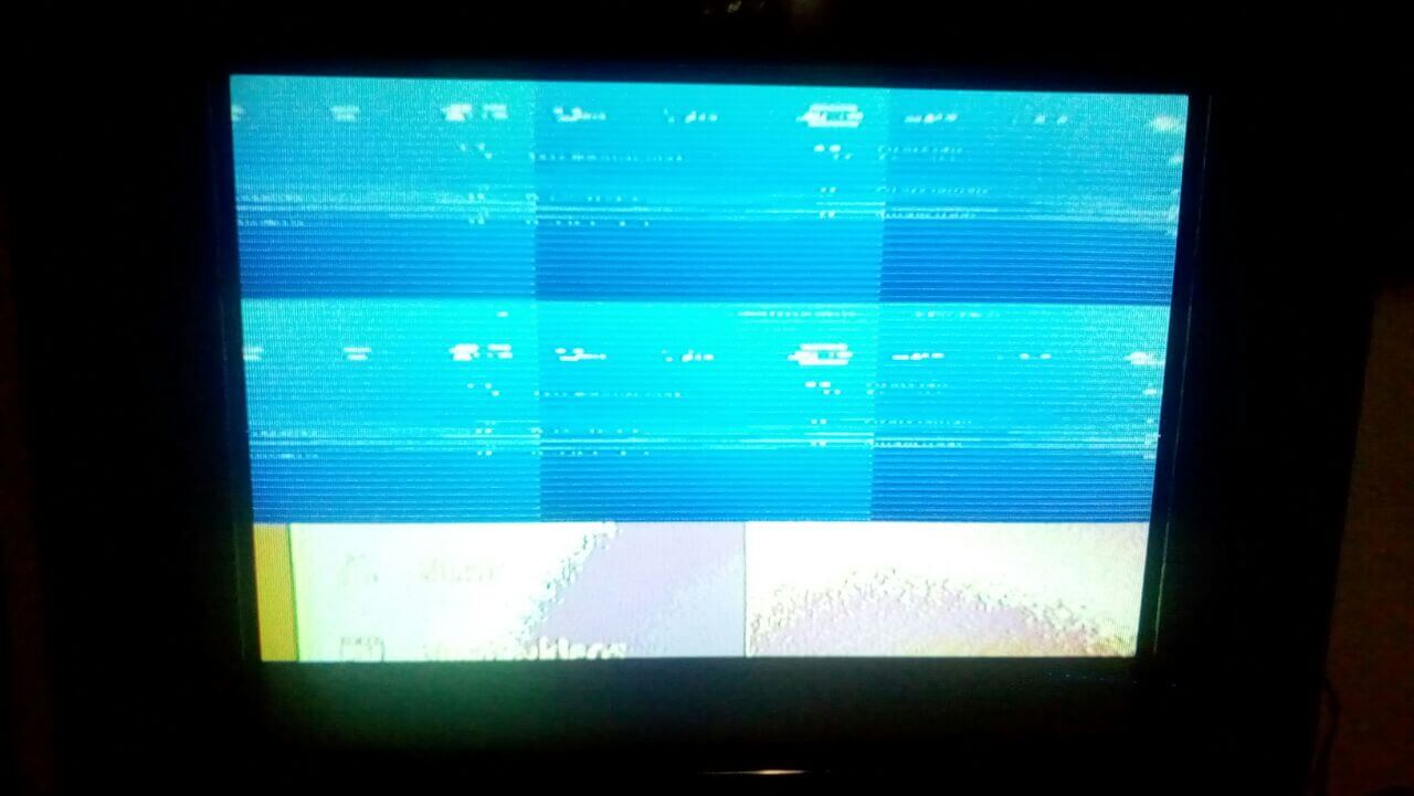

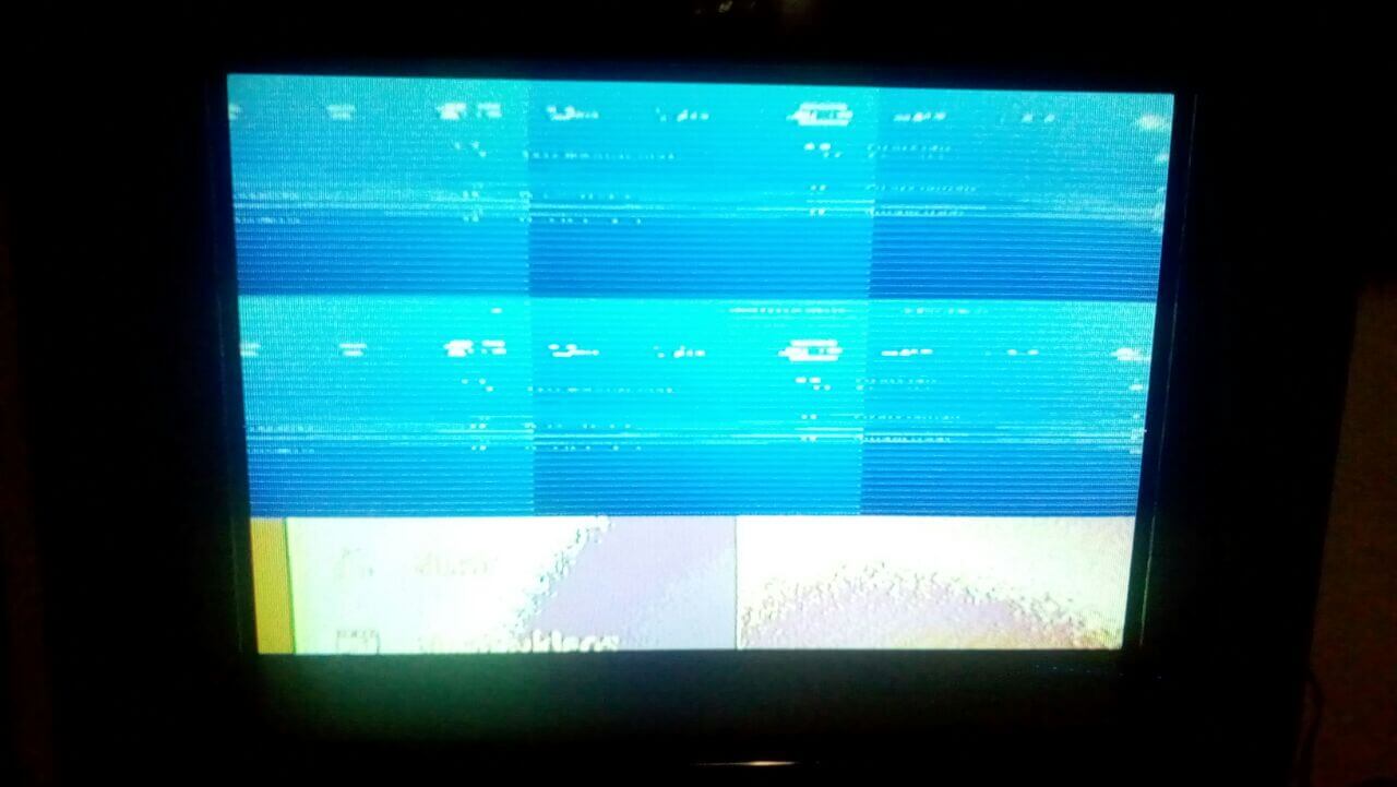

When i press left or right on controller i see the interface moving on retroarch wich means its running perfect!

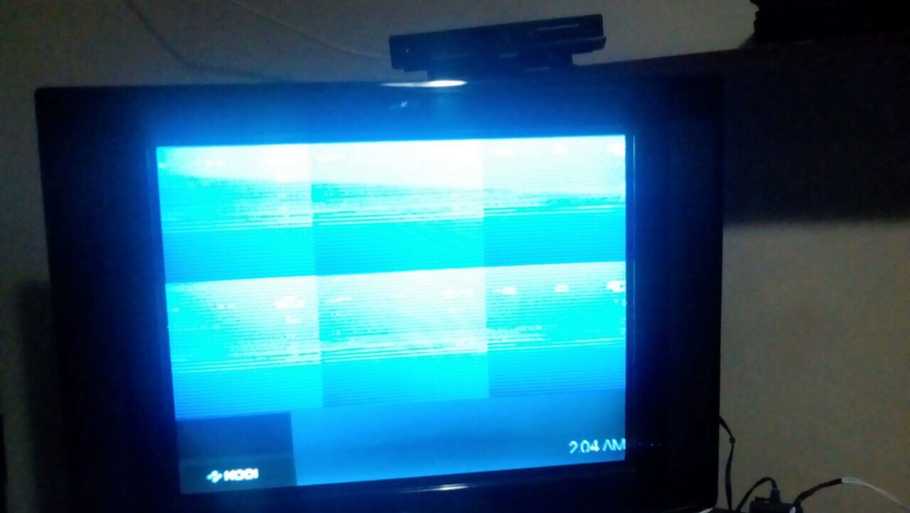

Retroarch runs like the screenshots....kinda blurry blue but kodi works perfect!
when i do
nano /storage/.config/autostart.sh
And inside
echo 480cvbs > /sys/class/display/mode
i see the image much better, but it still shows on display config that its 570i cvbs.

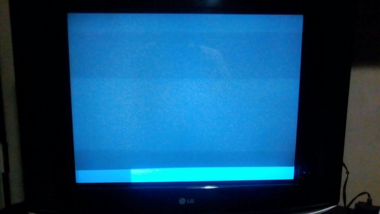

Emulationstation gives me black screen.
Any help on how to make em properly displayed?

I also saw that after some time it reboots and tries to boot again! ( it crashes after trying to set image and resolution to boot, similar to what happens on windows with bad drivers or unsupported resolution).

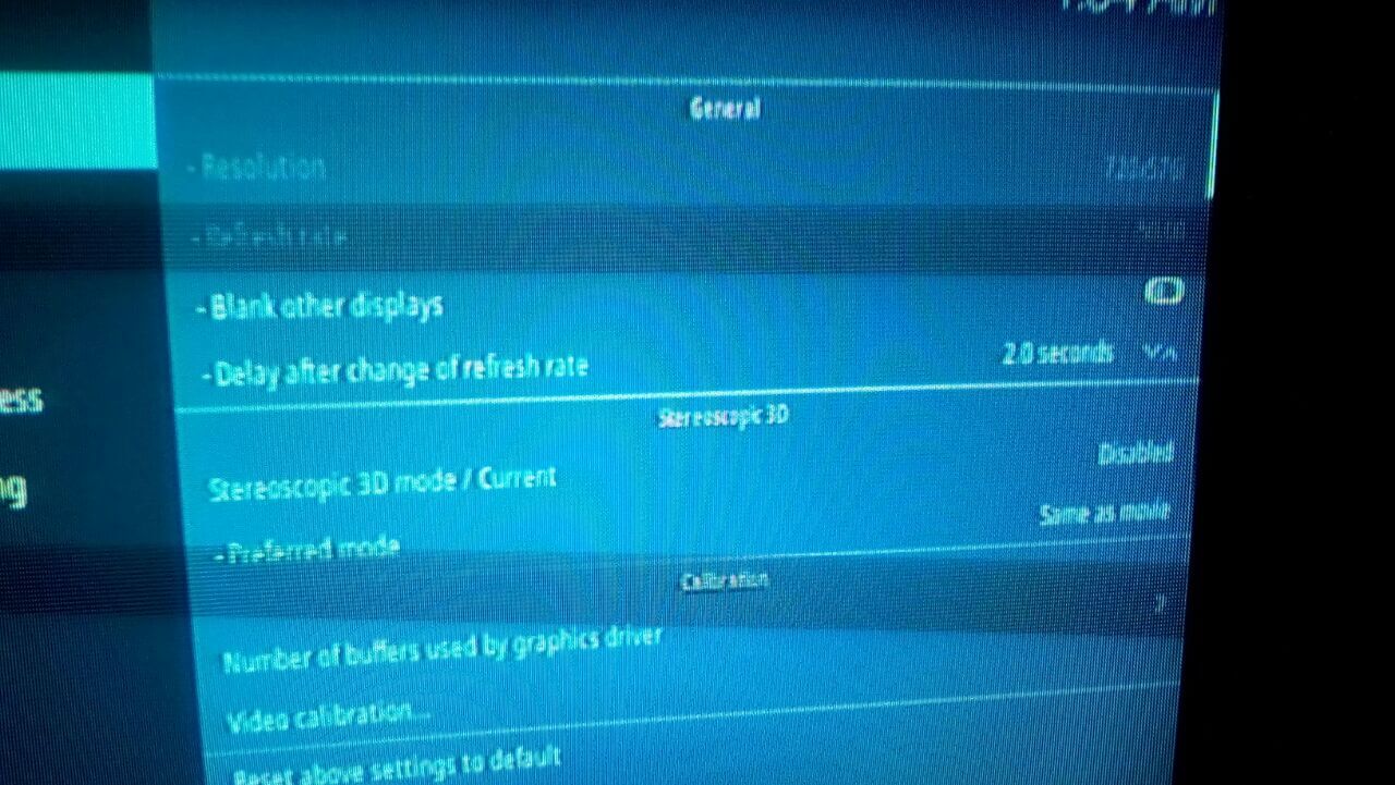

I tested the above stuff on an working libreelec image ( this one is LibreELEC-S905.arm-8.2-8.2.3.1.img) and on this one on display settings it shows resolution 720x570i ..even when on the autostart.sh its :
This LibreELEC-S905.arm-8.2-8.2.3.1.img also fails to run retroarch and emulationstation, gives the same problem as your OS, the difference is that with this one it boots up and i can see menus and work with it and even work with wireless and ssh, on yours i cant boot, only black screen and the bug happens on this image only when i open emulationstation or retroarch..your's the problem happens on boot.
Thats how this one is:
And inside
I see the resolution changes after the echo 480cvbs in there but display settings still blank showing resolution 720x570i..it makes me believe that using echo 480cvbs is not really changing the render resolution but only the menu resolution and thats why i cant make emulation station and other images to run here..
So any tips on how do we make it change?
Im ready to help you on testing to make it happen, just give me the directions and i can test it !

It worked on LibreELEC-S905.arm-8.2-8.2.3.1.img (but with this one the system changes output resolution and the emulation station and retroarch doesnt, i need to find a way to force both to follow the 480p resolution of the tv)....

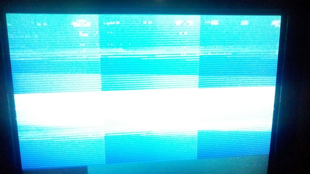

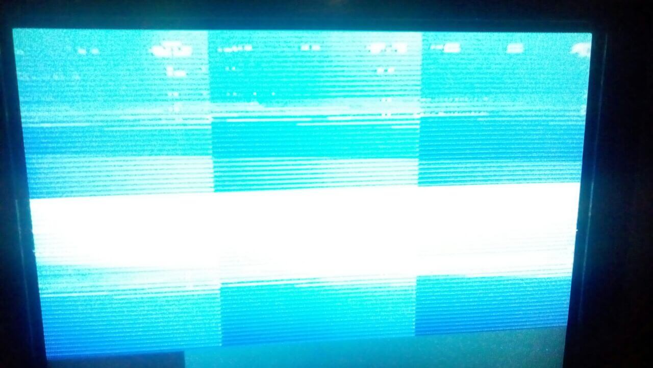

but Sx095re i cant even boot, i see the logo total broken and with artifacts and then blackscreen! ( is there a way to set this resolution using file manager on sd card or something? because it wont boot up and give me ssh =x
