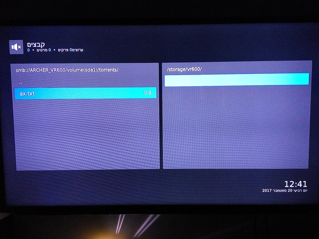

That's strange. I had something similar. See if you can force a higher Samba version on your NAS
it's a router (tp-link vr600) connect to usb drive. not a NAS.
this is what I have done:
1. create a file name: storage-vr600.mount
with this text (password and username are hidden for security reasons):
[Unit]
Description=cifs mount script
Requires=network-online.service
After=network-online.service
Before=kodi.service
[Mount]
What=//192.168.1.1/volume(sda1)/torrents
Where=/storage/vr600
Options=username=****,password=****,rw
Type=cifs
[Install]
WantedBy=multi-user.target
2. put it at my ki pro to this folder :
/storge/.config/system.d/
3. send this command through ssh:
systemctl enable storage-vr600.mount
4. reset the device.
5. then I saw the folder buy it's empty.
uploaded router setting,
as far as i know there's two places where you can set smb version. In the libreelec settings (min-max) and in kodi service settings (cant check right now but i believe that is correct).
I set the LE config to min: smbv2, max: smbv3. In Kodi services i set max to smbv3. That works here.
Also, i think that some nas systems require smbv1 to function
All set as you mention. Still no change.
The wird thing is that I can get reached to the folder with kodi file manager.
Did you guys read the first post about changes to SAMBA? LibreELEC (Krypton) v8.1.0 BETA – LibreELEC
I changed my SAMBA config from v1 to v3 and got full access to my Windows 2012 R2 server shares.
I changed it to v3 same result.

LibreELEC:~ # mount -t cifs -o username=xxxx,password=xxxx,rw "//192.168.1.1/volume(sda1)/photos/" /storage/test
mount: mounting //192.168.1.1/volume(sda1)/photos/ on /storage/test failed: Host is down
the peth change because now is set to share all at the rounter.
and test folder exist.
but now is shows host is down.
Use IP address instead of hostname.
LibreELEC:~ # mount -t cifs -o username=xxxx,password=xxxx,rw "//192.168.1.1/photos(sda1)" /storage/test
mount: mounting //192.168.1.1/photos(sda1) on /storage/test failed: No such file or directory
Through the kodi file manager I see the contents of the folder at:
smb://ARCHER_VR600/photos(sda1)/
Try:
mount -t cifs -o username=xxxx,password=xxxx,rw "//ARCHER_VR600/photos(sda1)" /storage/test
same :
LibreELEC:~ # mount -t cifs -o username=xxxx,password=xxxx,rw "//ARCHER_VR600/photos(sda1)" /storage/test
mount: bad address 'ARCHER_VR600'
mount: mounting //ARCHER_VR600/photos(sda1) on /storage/vr600 failed
hello guys
I tried to mount network shares folder with my tp link router without success...
im using usb storge connented to my router, with kodi file manager I can get to the folder, its look like:
when I tried to mount it with this command by ssh im getting error:
LibreELEC:~ # mount -t cifs -o username=xxxx,password=xxxx,rw //ARCHER_VR600/photos /storage/test
mount: mounting //ARCHER_VR600/photos on /storage/test failed
LibreELEC:~ # mount -t cifs -o username=xxxx,password=xxxx,rw //ARCHER_VR600/photos(sda1) /storage/te
st
-sh: syntax error: unexpected "("
thanks in advance
