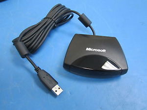

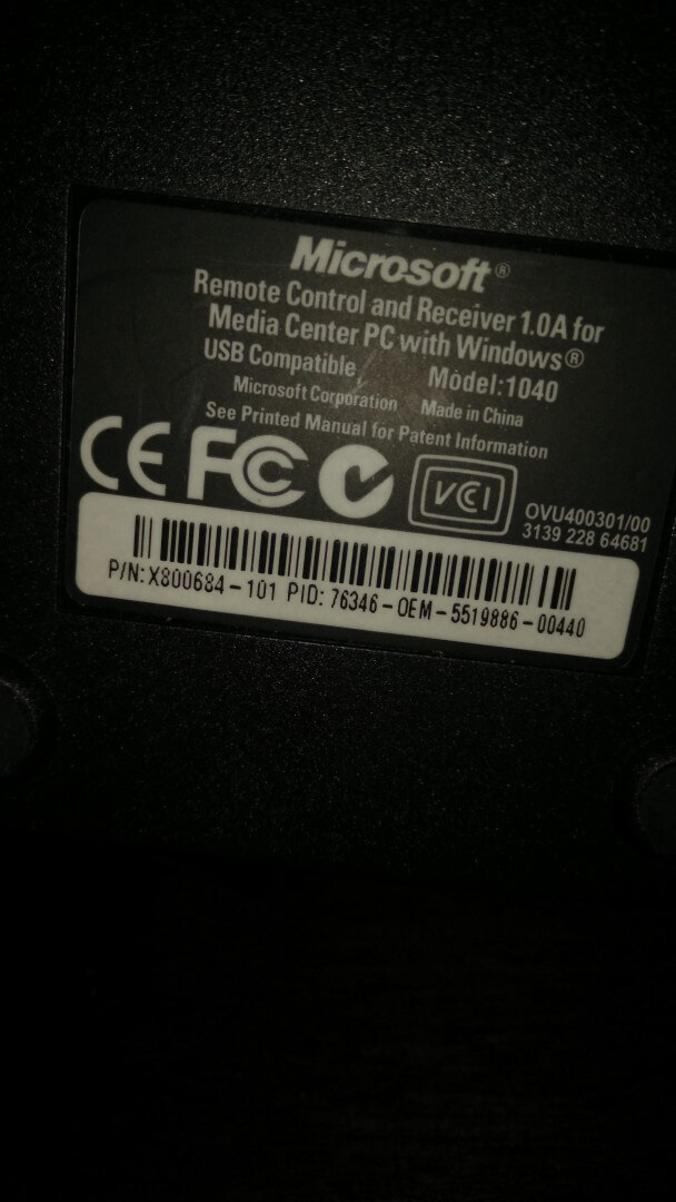

By serial console, you mean by RS-232 connection? I'm willing, if you can point me in the right direction. I might have a USB2COM adapter at work, but I getting a laptop with a com port will be more difficult. I'm now 99.99% sure it's the MCE adapter. I haven't had a freeze since I've disconnected it. It's quite an annoying thing to troubleshoot, because I can't connect to the box when it freezes.
Yeah, don't put it into standby.
Thanks for pointing that out. I don't put it in sleep mode, I power it off. It's still in standby, though.
kszaq I think I've found the cause of my problem, now I'm hoping you can find a solution.
I have an official Microsoft USB MCE remote receiver attached to my box. If I disconnect it, my box seems to boot fine (last six times I've tried all went well).
