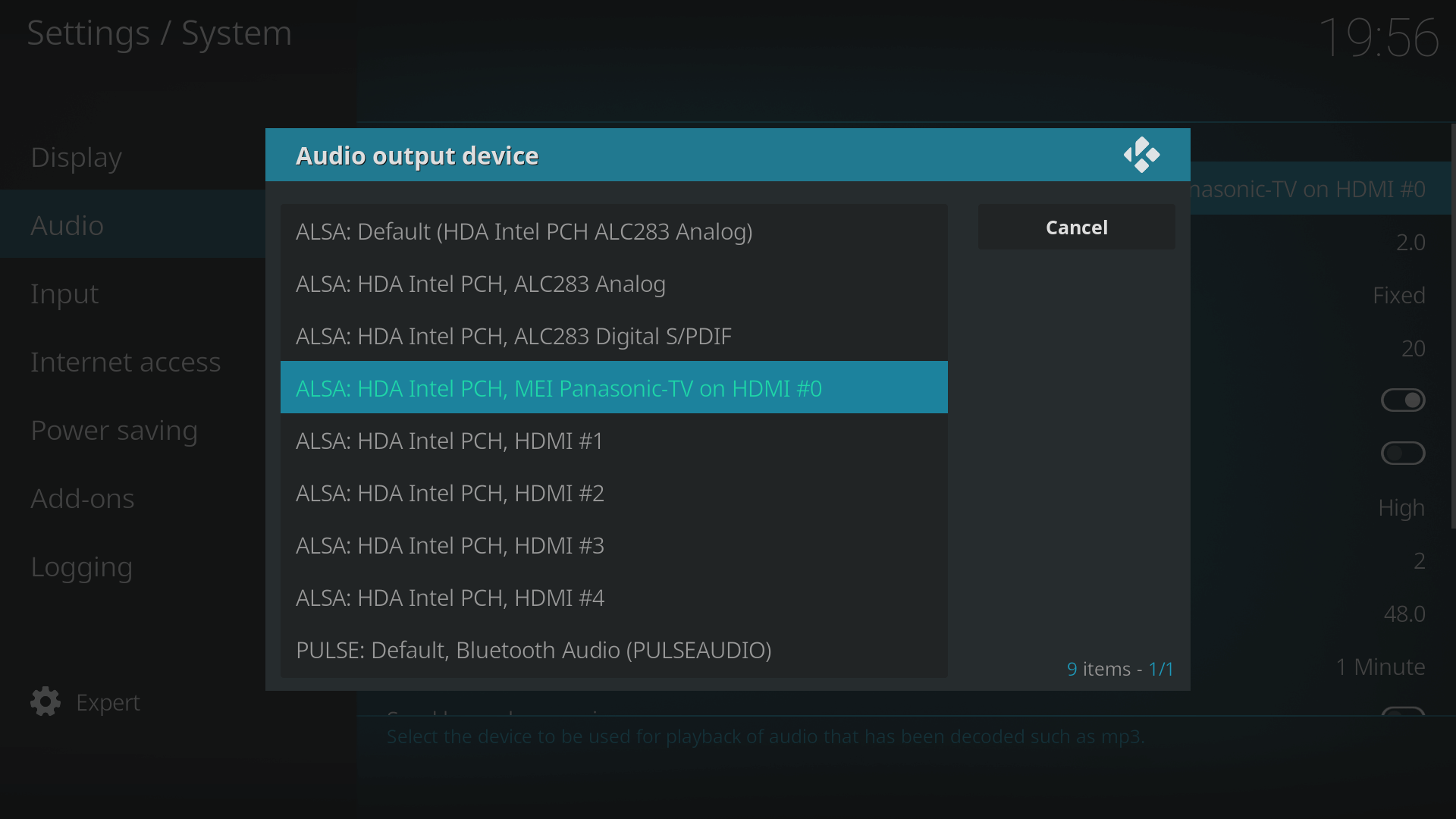

    Suggestion 1) : I don't have those devices to choose from.
    Suggestion 2) : I tried your setting - no difference. I will leave the video settings on default for now.
