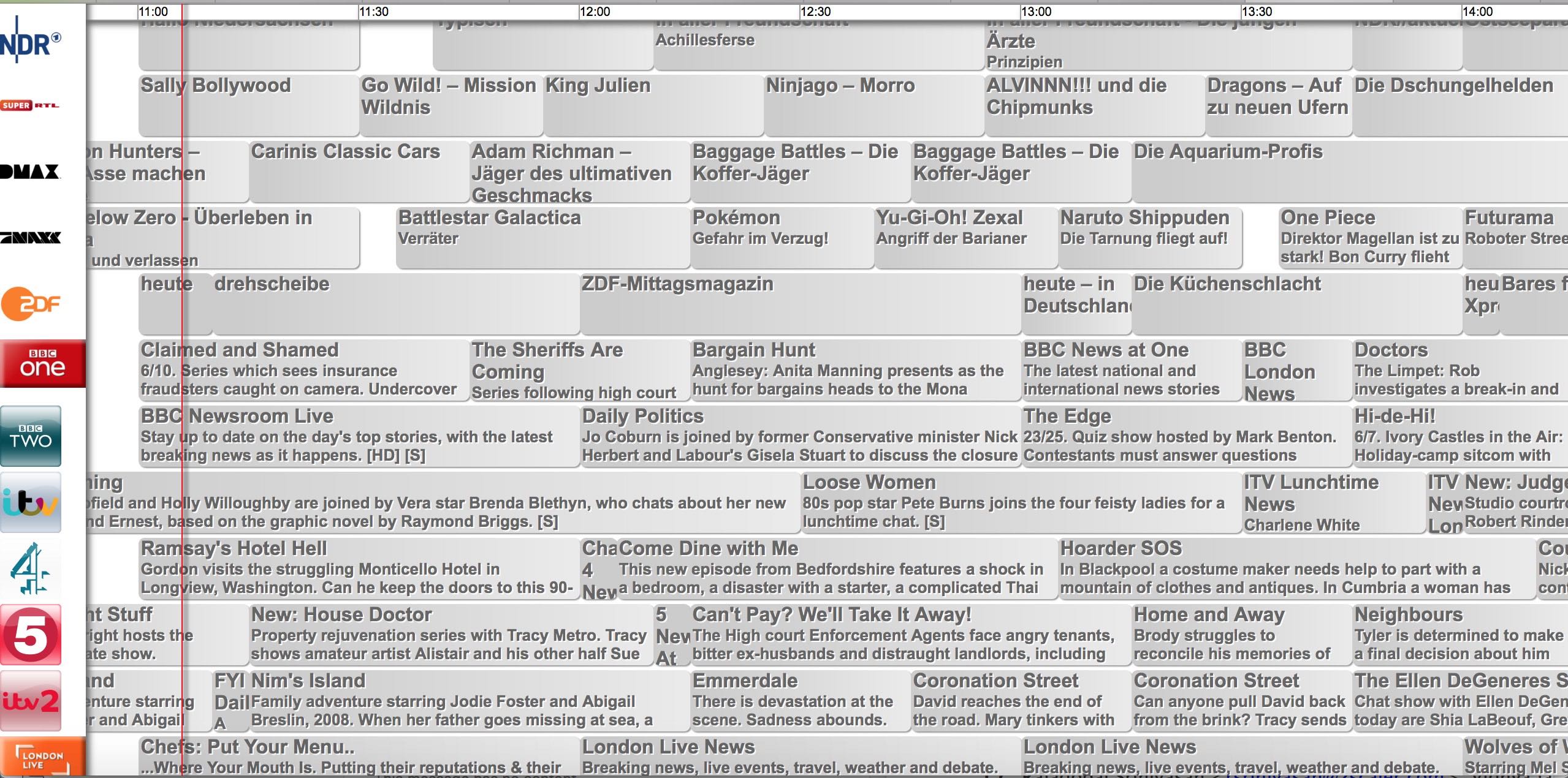

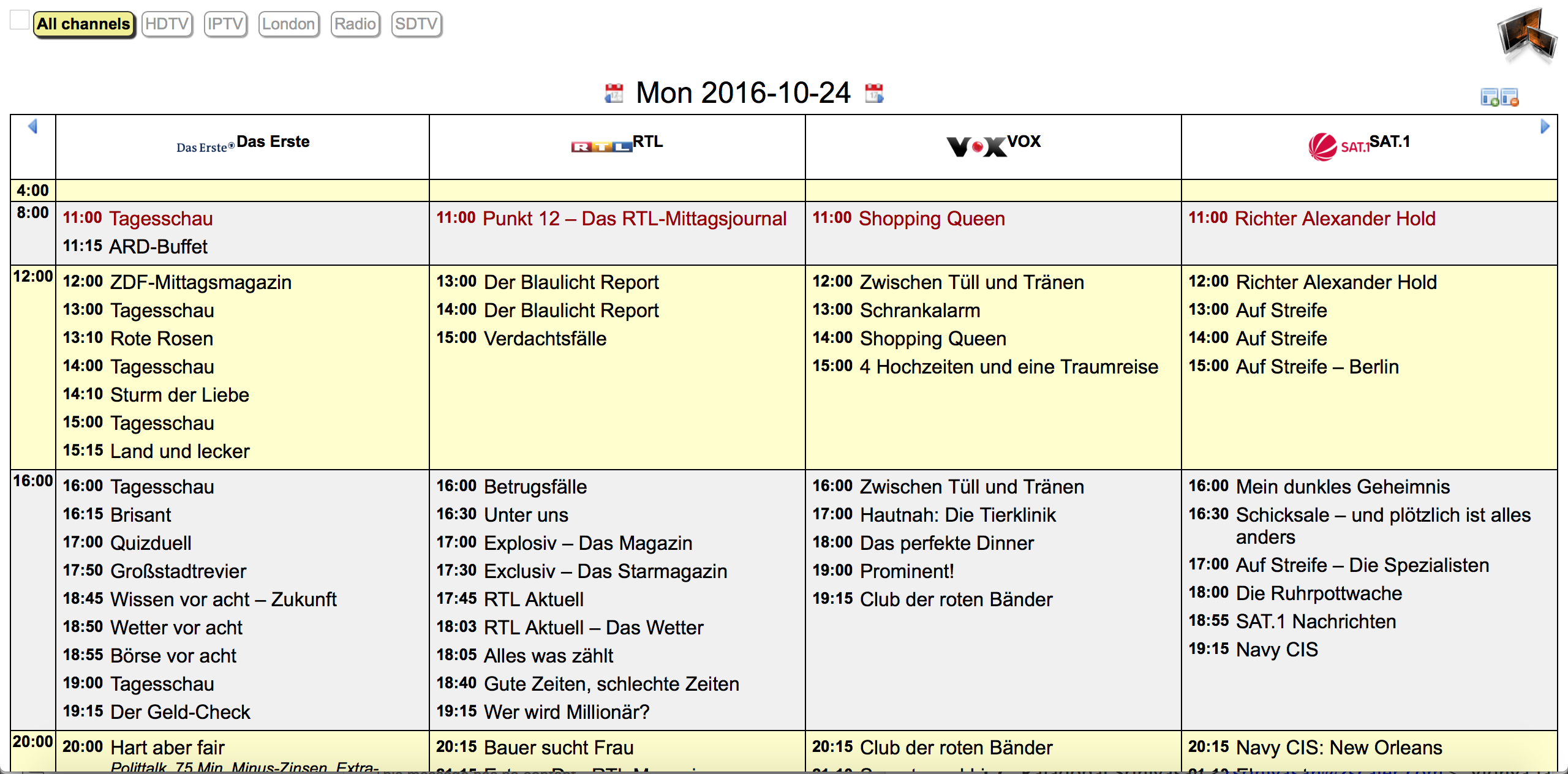

    Just adding to my previous post I've now created my first ever plugin for kodi which uses the mobile layout from polini.
    Few things to mention for now:
    1. Make sure it's on the same kodi install as your TVH server
    2. You might need to set the "HTTP CORS origin" via Settings -> General -> Base (e.g. 192.168.1.5:8080)
    3. I've disabled authentication for some machines on my local network so authentication is not implemented yet.
    To be done:
    My aim is to add a configuration option to the add-on so IP, port, user and password can be entered however I'm yet to find a suitable solution for this.
    Please note this add-on is a very early stage I was mostly interested in the EPG and mag layout which both work fine.
    Any issues suggestions etc please do post them.
    webinterface.NiceTVH
    The interface will be reachable via:
    http://{Kodi-IP}:{Kodi-Port}/addons//addons/webinterface.NiceTVH/
    I will add a better description to github once I find some free time for it.
    Screenshots:
