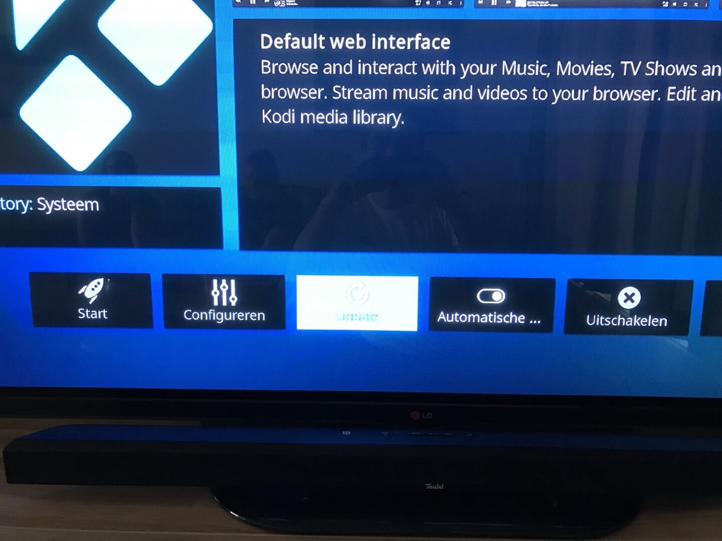

    Thanks for the reactions. LibreELEC version is 8.0.2. For example the add-ons (webinterfaces): Arch, AWXI, Chorus, Hax are installing but the start button is still grey. Also (i think installed by default) Kodi web interface - Chorus2. Is installed but not starting, they also not available in the add-on menu (i added a screenshot, hard to see but configuration/ start is greyed out). I see no where a option to "enable" them. Iam a noob with this, so if i do something wrong or you guys need more info ask me.

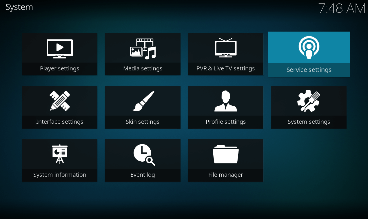

    Like it's being said, you have to enter the service settings:

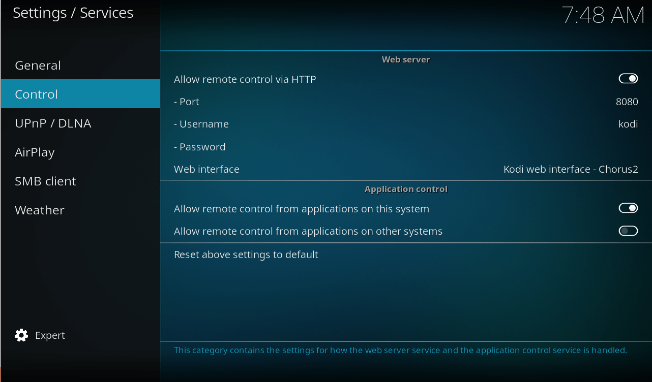

    And then the control-section:
    Inside that section you will see an option which is called "Web interface". At that option you are able to choose which Webinterface you want to use and Kodi will start that service for you. But that's not directly visible. Only if you connect from a browser to the IP of you Kodi machine.
    If it's the same PC (so browser and Kodi on the same PC), you are also able to enter: 127.0.0.1:8080
    at your browser. As 127.0.0.1 is always your local host. the "8080" is the port which is specified for the webserver. if you change that in the settings, you need to connect to that port.
    if it's another PC you have to check the network section of the system info to get your internal IP of that Kodi machine and then connect to that.
