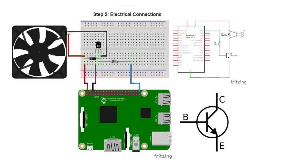

  • HI..been looking for some info and giving up now...I m trying to get a fan to work with my raspberry pi..with some kind of control when rpi reaches let s say 50 degrees fan goes on...below 50 goes off..I understand that there has to be a small circuit and transistor to gpio pin...I m more stuck at the scripts bit and if there is a way to make them work with libreelec from something like raspberry pi tools addon...Hopefully someone who got it working can share some knowledge..and some easy steps....I found few howto's online but none point to libreelec..

  • Thanks for your replys...I installed the raspberry pi tools addon and I can build a simple circuit from fan to transistor to raspberry pi gpio for control and power from power source or raspberry pi itself 5 v pins...

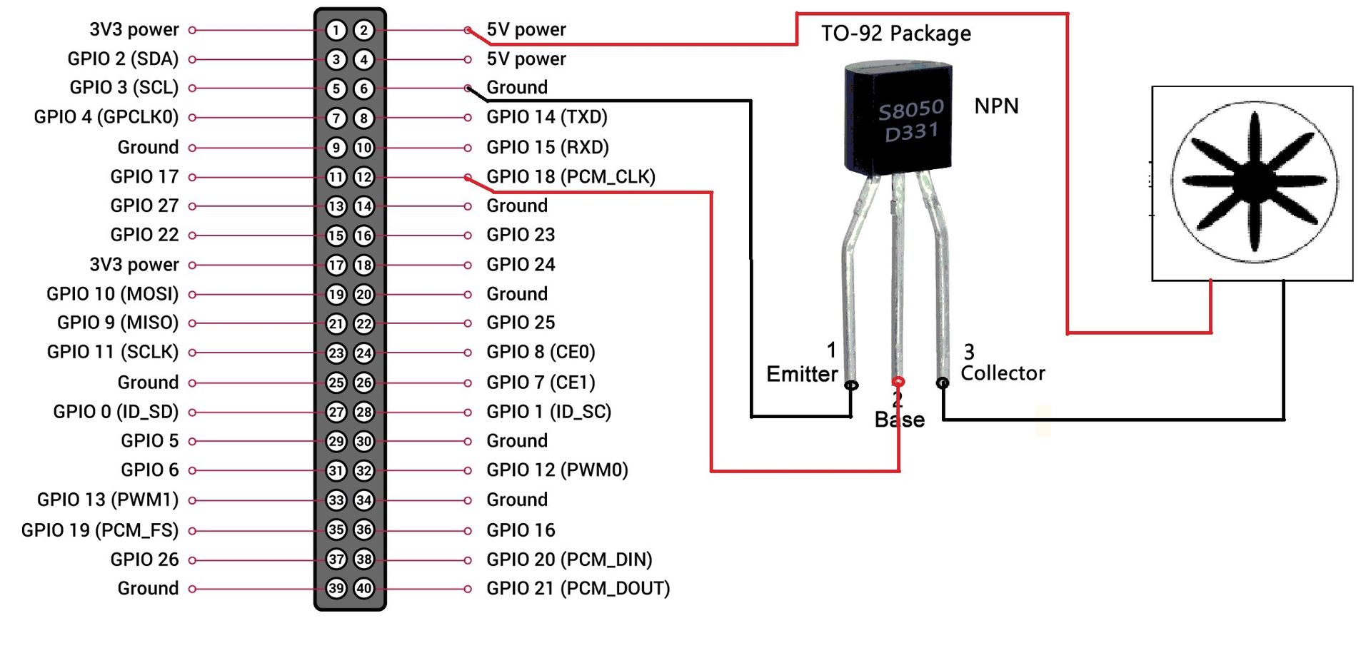

    Hi GaryB...that is exactly what I m planning to do...did you use a transistor or a relay?I think the electronic part would be easy enough for me to set up and seen lots of guides around how to connect from gpio to transistor or relay and 5 volts headers..I m stuck how to control the fan from script...have no idea what to do...did you use the raspberry pi tools addon?
  • I used an S8050 transistor, I think a relay would draw too much current.
    Yes, I used the Raspberry Pi Tools addon for the GPIO library.

    Did you use a resistance?
