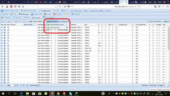

Can you add these properties map service all and map selected service
I will work on that section next...I have to rework the way I built the map services section...so it will take a day or two to finish.

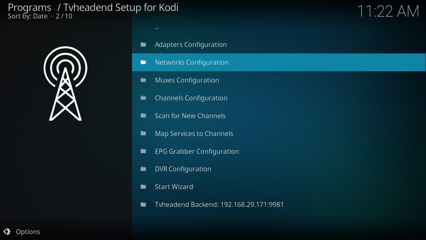

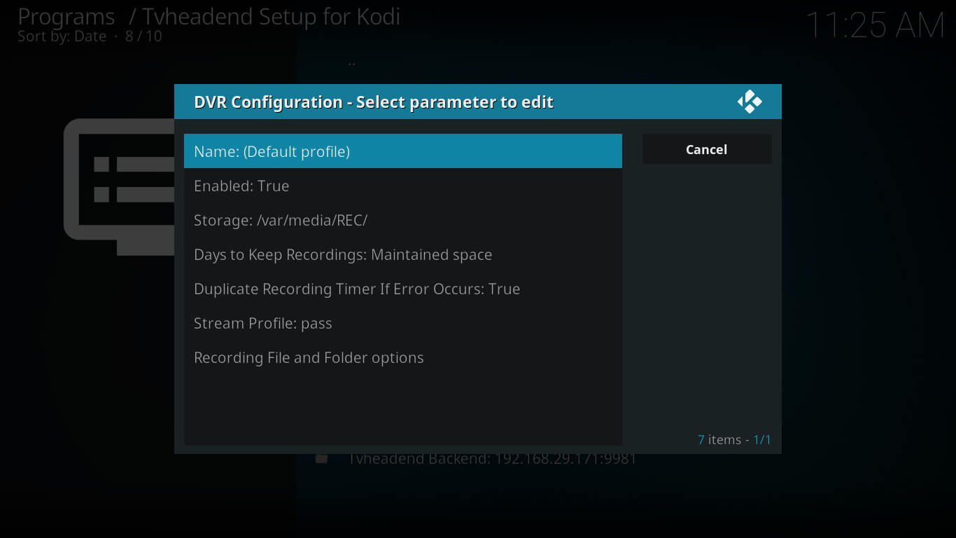

Github updated with the new 2.0 release...
Releases · edit4ever/script.module.tvh2kodi · GitHub
This update adds the following:
- Support for DVB-S networks
- Support for Conditional Access Clients
thanck you
FYI - I forgot to include the DELETE option for the CA clients - I uploaded an updated 2.0 version...

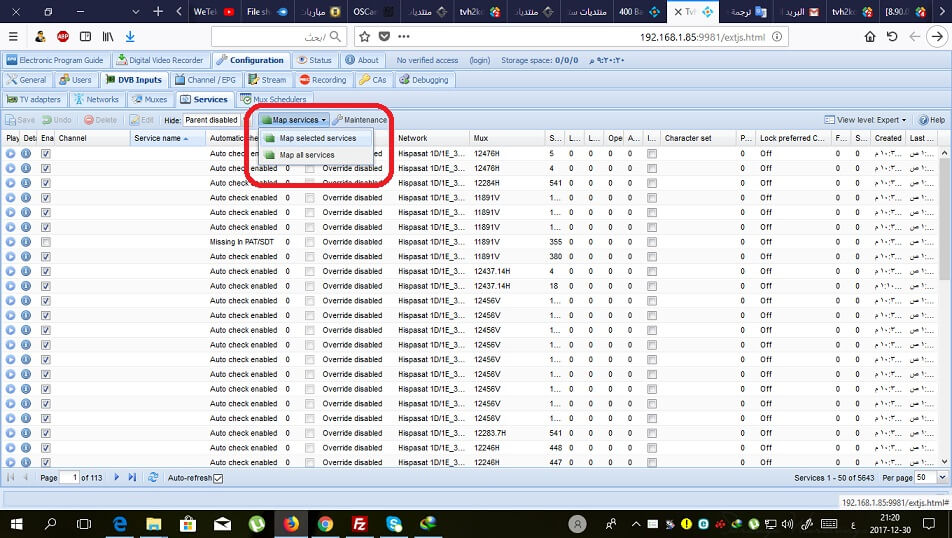

belaid38 here is a version with the map selected services option...
script.module.tvh2kodi-2.1-TEST1.zip
Please let me know if you have any issues.
Thanks!
Display Morebelaid38 here is a version with the map selected services option...
Thanks!

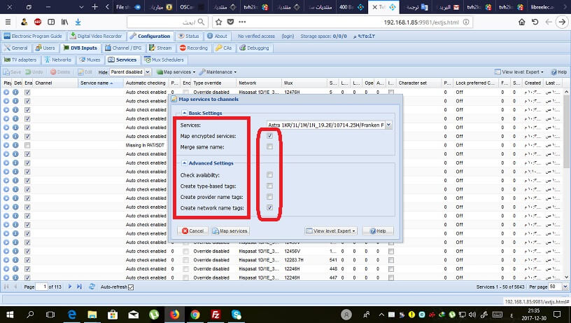

hi edit4ever properties map service for map service all is work
but map selected service not work
belaid38 Thanks - looks like some of your services don't have names...can you please put the following into a browser and provide the results:
Thanks!

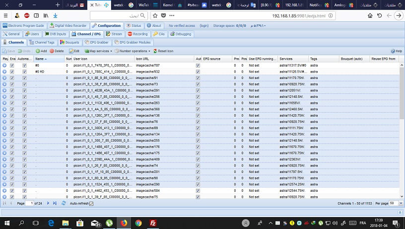

Please add delete channel tags after map service
belaid38 Thanks - can you also provide the results from this:
I will look at adding tag management to the channels section.
edit4ever map selected service work fine thanck you
