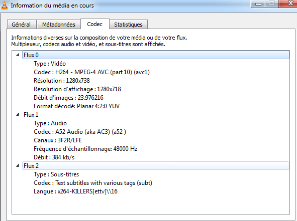

    Bellow is the codec list of a file I cannot read. It seems to me that Pi should be able to read it, shouldn't it ?

  • If those MKV files contain 10bit versions of the H264 format, your Raspberry Pi is not equipped to handle those.
