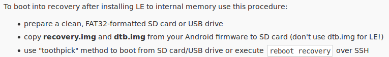

  • I'm in the process of reverting my Nexbox A95X S905 (non-X) from LibreElec (installed on eMMC) to Android. According to the LibreElec install FAQ, I simply need the original firmware's recovery.img and dtb.img on a FAT32 USB coupled with the toothpick boot:
    I don't have access to the original firmware and the two files mentioned above aren't anywhere to be found online.

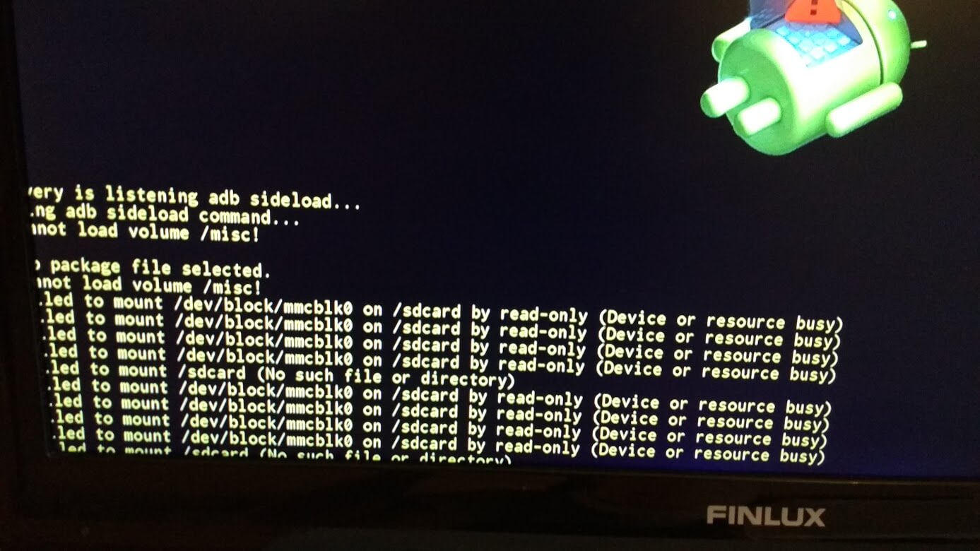

  • When I tooth-pick boot to USB recovery and try to flash an OS image, I get two errors:
    1) cannot load volume /misc!
    2) failed to mount /dev/block/mmcblk0
