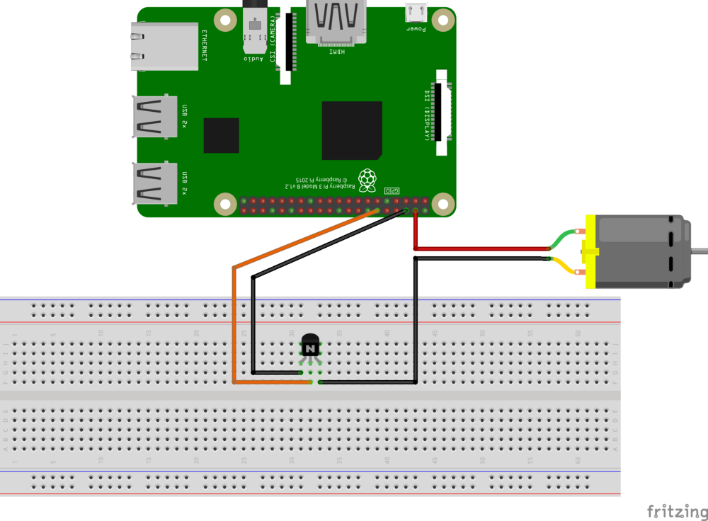

    I am trying to create a background service which should start when libreelec starts and monitor the CPU temperature. If the temperature goes beyond certain limit switch the fan ON. I have almost got all the hardware ready and connected to the GPIO (pin 18).
    Below is the script I manage to create so far. Please let me know if this will work or not and specifically if this is fine or not. I am planning to install it as a service addon uisng zip file.

    The circuit diagram is as follows. The DC motor is actually a fan. Never connect motor to rpi like this.
    Thank you.
  • Years ago, I played around with a kickstarter project called "HotPi" which did exactly what you are hoping to achieve (albeit on the RPi1). Some of the documentation may still be around which will give you a few clues. However, I think you may run into problems if some of the python modules are not available in LE.
    Also, I found that the noise of the fan was annoying whilst watching a movie.
    If you're overclocking the RPi3 (and possible other performance "tweaks") your going to have to expect temperature problems.
    Ways around it are to remove the lid of a case if any, install a heatsink (don't use a heatsink if enclosed in a case - counter productive without a fan).
    What I ended up doing, was just using a small 5V fan connected to 3.3V and Gnd. It's slow enough to be quiet but effective enough to keep the temperature around 40 degrees with normal usage.
    A red thermometer is the sign of overheating (Actually when the RPi3 throttles back) a yellow zigzag is a sign of voltage issues.
    You won't be able to see what processes are using the system as the system is still starting up - having transmission, couchpotato and sonarr are not going to help unless they are delayed on startup.
  • Thanks. I do have heatsink installed. The plastic case do have good ventilation, but I feel its not enough. The fan I have is the same you are referring to, it came with the case and runs fine connected directly on the pwr & gnd pins. I am planning to add delay to all those services so that I can even out the load on startup. I wanted the script so that the fan does not run continuously as you said it is annoying while watching movie. I have seen that while watching anything temperature is below 55. Do you have any idea on what the error is in the scripts above. I cannot install it using zip file and no error is logged as well so I am kind of stumped.
  • I would try running the script from a terminal - python myscript.py and see what errors you get. Also I would install the LE add-on RPi-tools as that may have some of the modules needed.
    Also some of the data refers to xbmc, this may have change to kodi - you'll need to check.
  • I did the same project a while back when i built my raspi NAS setup. I got help on the raspberry pi forum to get it working. I never did get it quite right though, i could turn the fan on and off, but it wouldn't work on temp control. I powered my fan from a usb plug and used the transister as a switch to ground. I also put a .5 amp fuse between the pi and the transister to protect my pi. My coding skills are less than minimal, but the raspbery pi forum is a great resource.
