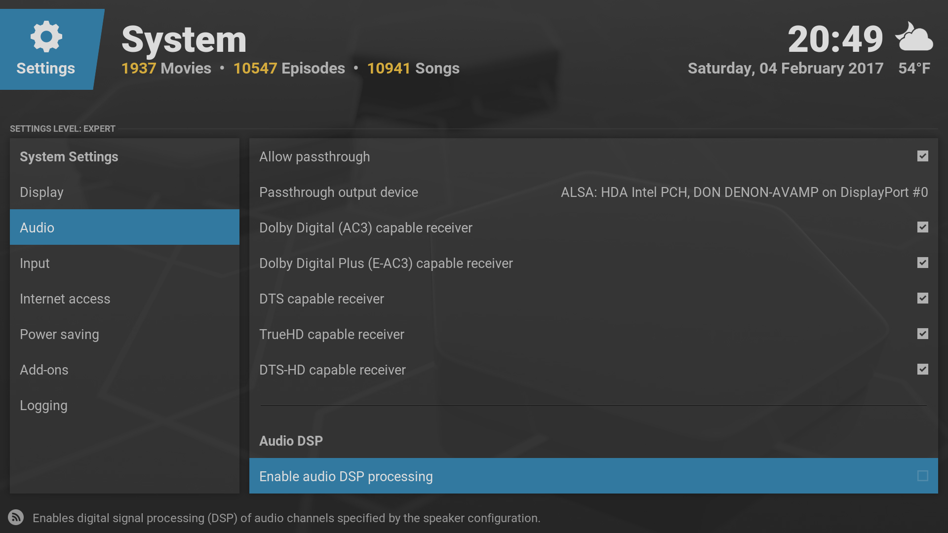

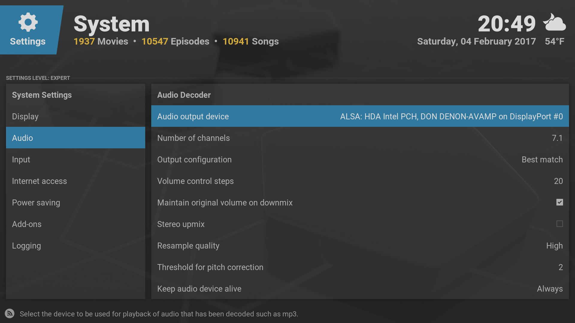

  • I upgraded my NUC from a Haswell (NUC5) to the new Kaby Lake (NUC7), mostly to get hardware 10bit HEVC at some point in the future. I restored my backup from the NUC5 to the NUC7 and validated all my settings. Unfortunately, I'm no longer able to bitstream lossless audio. Standard DD and DTS work fine, but TrueHD and DTS-HD generate no sound at all. My receiver acts as if no sound is being sent. If I disable the lossless options in settings, TrueHD seems to output as LPCM and DTS-HD downgrades to core, as expected.

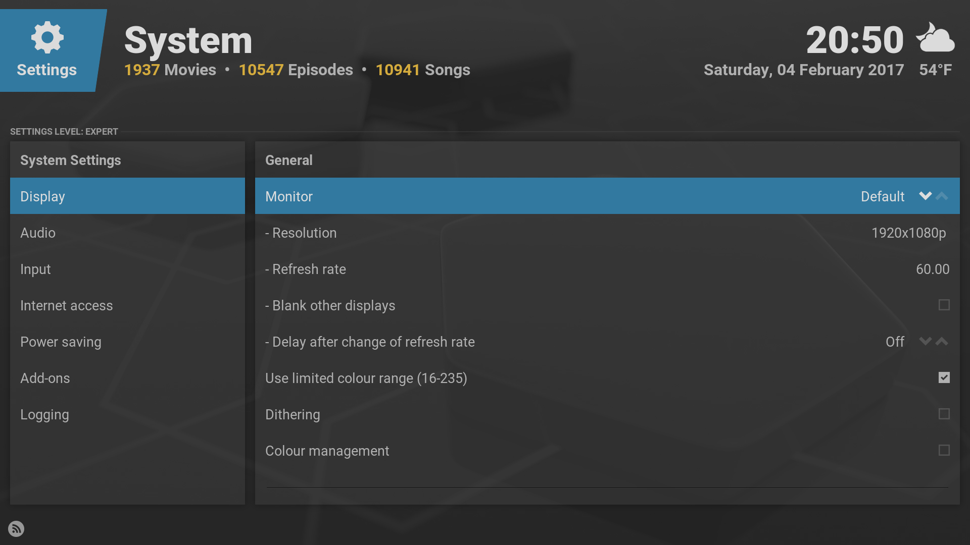

    The only oddity I see that's obvious is that X seems to think it's on DP1 rather than HDMI1, but it looks like it considers them clones so maybe that's normal here. Also my xrandr output shows an incorrect "Broadcast RGB" setting, it should be forced to "Full" by autostart.sh. This was a previous Kodi best-practice for proper black levels (TV set to limited, X output set to full, Kodi set to limited), but perhaps 17+newer GPU has created some synergy here that I'm unaware of and "Video 16:235 pass-through" is expected now. I only mention it in case it's further indicative of some problem with the output device, the audio problem is the only thing I'm intending to report here.

  • TV set to limited, X output set to full, Kodi set to limited

  • Also my xrandr output shows an incorrect "Broadcast RGB" setting, it should be forced to "Full" by autostart.sh. This was a previous Kodi best-practice for proper black levels (TV set to limited, X output set to full, Kodi set to limited), but perhaps 17+newer GPU has created some synergy here that I'm unaware of and "Video 16:235 pass-through" is expected now.
    Yes it is on Intel GPUs. It's basically a "Full" mode which also implements the Intel zero copy approach to directly render the decoded NV12 surface.
  • Hello,
    the bug with the HD Audio is well known. It is a problem of the intel drivers. Some people report they have the same Problems under Windows 10 too! In KOdi froum is al long thread about this problem.
    Intel Apollo Lake
    I have also the same problem and hope that intel will fix this bug.
  • Call me stupid, but why would you limit your devices when they are probably capable of doing full colors? Limiting the black colors will give you a washed up greyish layer over your display. I would disable the limitation and always go for full colors, on the htpc as well as the TV.
    You may have to up the brightness/contrast on your TV, but in the end the colors come out better.
    Because you do not want to scale the original limited color range of the source material if you are a hard core purists--losing BtB and WtW video signals. Another reason is if your common denominator needs to be limited when using an AV receiver and outputting to one input on the display.

    Intel needs to update the drm-tip drivers from what I understand. 98797 – BXT - HDMI - HD audio passthrough dont work
    I am quite confused with what changed with the latest NUCs starting with Skull Canyon when it comes to the different modes for xrandr Broadcast RGB. It seems as if though Video 16:235 passthrough no longer functions. I made this post over on the Plex forums covering this issue as well as any other issues for Apollo Lake and Kaby Lake NUCs

  • Same problem with an NUC7i3BNK here, too, regarding the bitstreaming of HD audio formats. Installed Windows 10 last Thursday to confirm it's somewhat related to the DP to HDMI conversion chip's firmware. Initially no HD-bitstreaming worked in Kodi under Windows, applied the 1.66 Megachips firmware update which fixed it there. As stated by the OP in this thread this doesn't help with LibreELEC though. Guess we'll have to wait for an updated driver for Linux or something along those lines.
