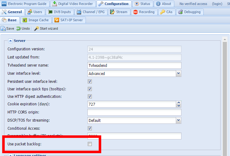

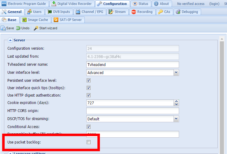

Packet backlog in tvheadend settings is off.

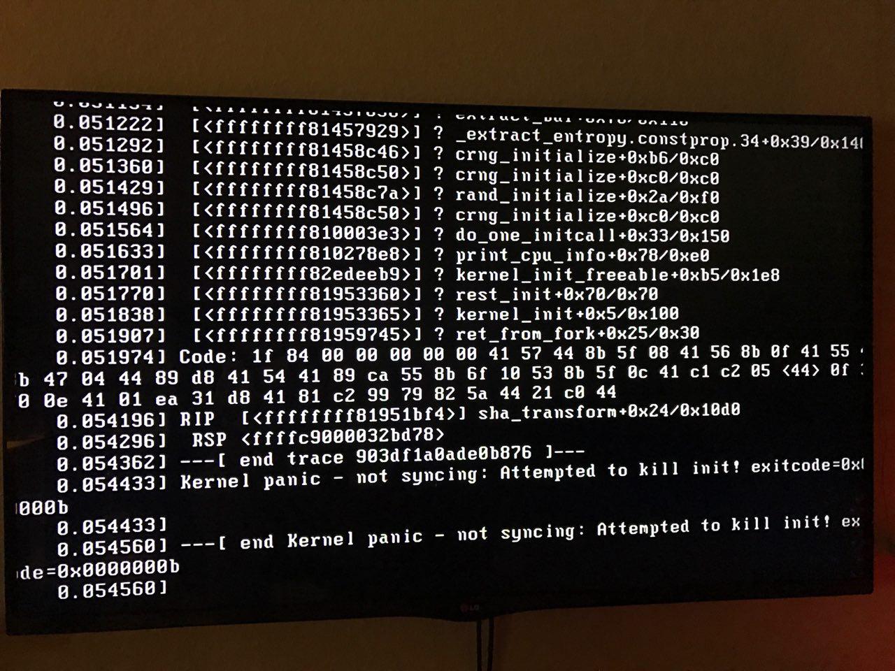

With the latest intel drivers I get a kernel panic on boot. (I copied the KERNEL & SYSTEM files to an installation stick from alpha 10 and typed live at the promt)
