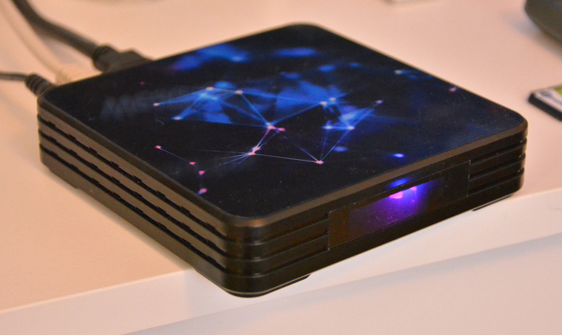

  • I want to share my current config of a generic Tanix clone, a cheap chinese android box from ~2020 with an H6 called the "Z3". It came with a horrible version of Android 9 labeled "ZMAGIC" upon boot, very slow and buggy, and strangely without any spyware! Obviously, I replaced it with LE anyways, and have been using it without any major issue. It's very capable of playing 4k videos, and even Playstation 1 games without any framerate drop.

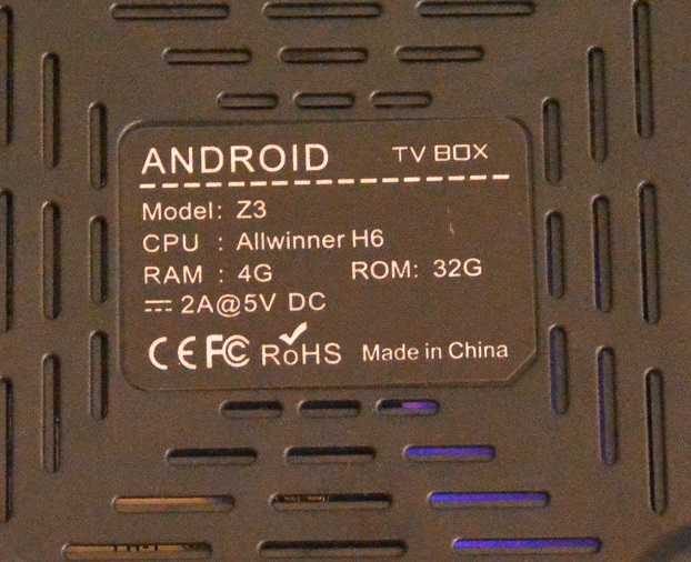

    It has 32 GB of flash storage and (theoretically) 4GB of RAM, but LE can only see 3 GB, I still don't know why.
    Here's some info and pictures:

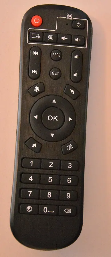

    The first thing that I configured was the remote, because it was not working ootb at all. I captured all the scancodes and created a TOML file inside /storage/.config/rc_keymaps/
    Here's the contents of the TOML file I managed to create, all keys working, even the default non-configured "TV" buttons:
    The remote does not have Pause and Stop buttons, so I replaced "Apps" (Yellow) and "Set" (Blue) with this:
    0xdf01 = "KEY_PLAYPAUSE"
    0xdf5f = "KEY_STOP"

  • It has 32 GB of flash storage and (theoretically) 4GB of RAM, but LE can only see 3 GB, I still don't know why.
    Open the box and see whether you have 2x 2GB or 3x 1GB DDR RAM chips on the board. The 3GB RAM config is quite common on Android boards, with stickers lying about the installed RAM size (and Android hacked to show 4GB) also not unusual.
    H6 can address only 3 GB of memory, despite having 4 GB installed. It's normal (HW limitation). I believe Android usually displayed installed memory, not usable, to produce better numbers.
